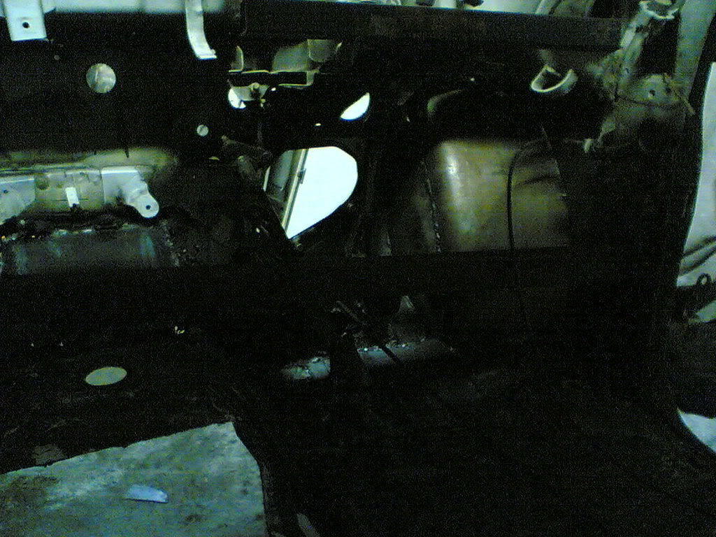

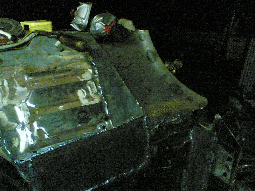

TB
tommy b
inside, full frame and body dropped on an 82
outside, the other parts are for taking out rust and what not.
only relocting is the accelerator peddle
twisted minis's avatar
twisted minis
Pictures from our trucks won't help much Thom. Ours need to to be tubbed a lot just to lay frame. My tubs go all the way up to the pinch on the firewall. Yours could probably look more like this.
