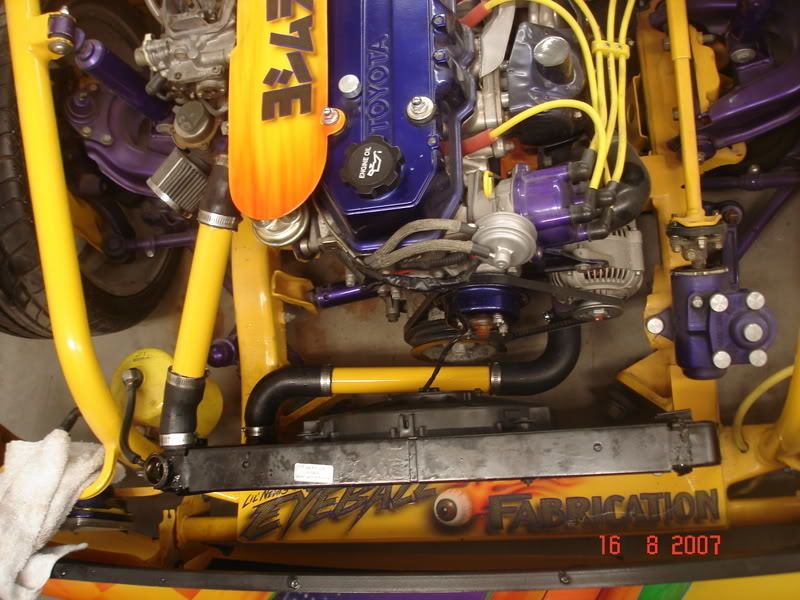

What about something like this...its the lower radiator hose off Last Look & its for coolant, but dont see why you couldnt make something like this for gas!
m_i_zombie
Your close to what I need, sort of. Take out the straight tube and put the 45's together. Radiator hose isnt made for fuel, it doesn't hold up very well to the fumes.

Yea...dont use radiator hose, I was just saying what he did for the coolant flow problem might work for you.
