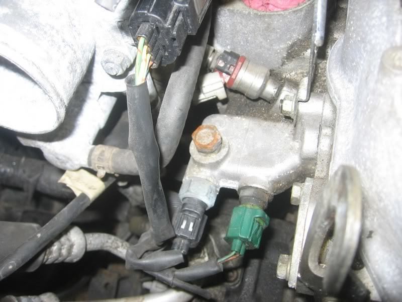

Ok first I think in the haynes manual it looks like theres some sort of fitting for 2 vacuum hoses to connect to.. As you can see in the pic, it was replaced with a plug. Anyone know what its actually called?
OK.. now do these 2 hoses connect to the missing part in the picture above?

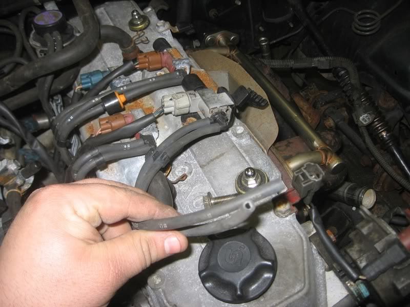

I notice all the other hoses on the plugs on the valve cover go to the metal lines between the head and the intake manifold.. But they all are filled. So all i can think of is that they go to that missing piece.

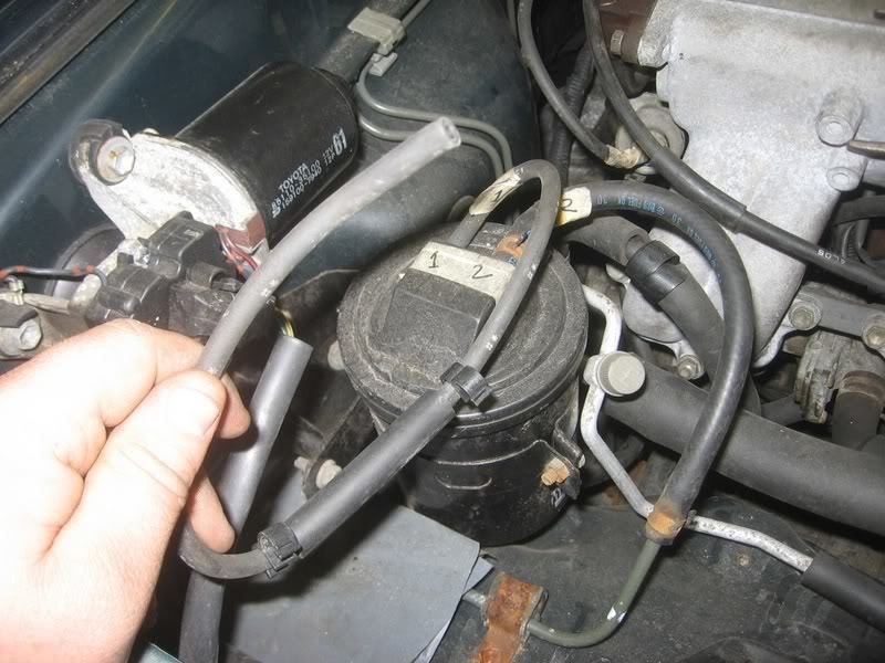

ok. now Heres 1 hose on the charcoal canister. Not sure where thats suposed to go either.

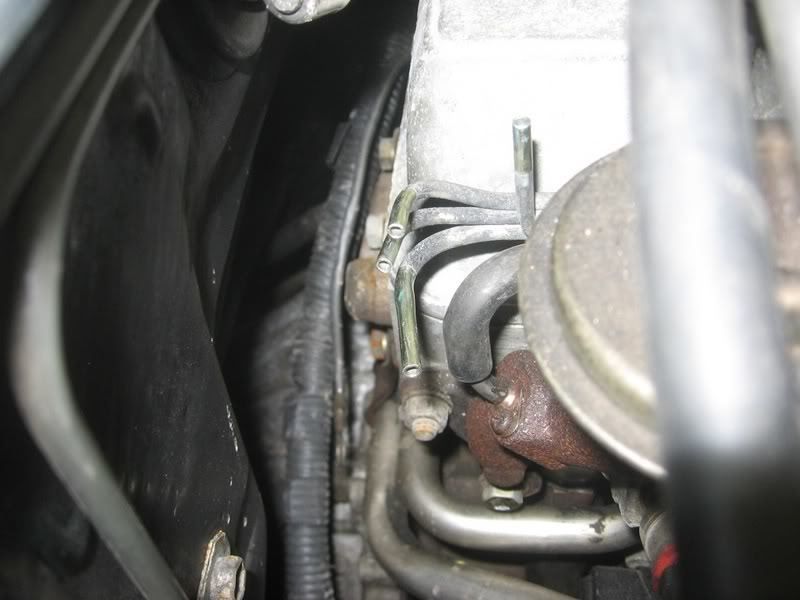

Heres another

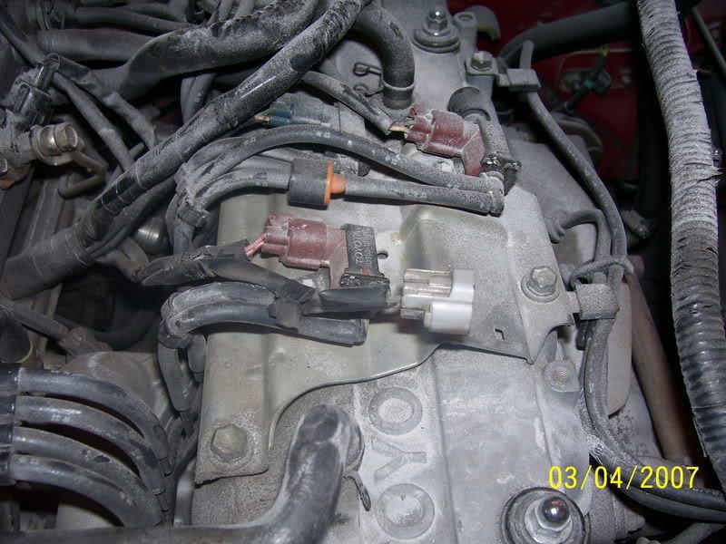

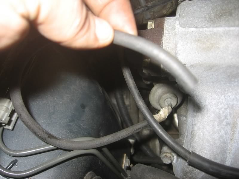

And these 4 metal lines. they run between the head and the intake manifold.

Ok so the one line from the charcoal canister(pic 3) goes to the bottom hard line on the set of 3 on (pic 5)
(Pic 4) from the fuel rail-goes to the top hard line not the one pointing up though .
Then there is another vacum line that needs to go from directly under the passanger side of the EFI, coming out of another one of those things like in pic 4 but bigger- .like this-
one goes to the middle hard line
So the hard line pointing up goes to the thing right next to it like this
That takes care of pic3,4,and 5.

Awesome bro.. Thanks that helps alot!!
