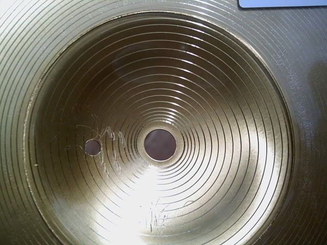

Only problem I have had with fitment is the spindle comes out too far and I cant get the center cap on till I grind it down a little. The front bolt on the strut bars barely touches the rim lip, grinder will take care of both of those issues.
