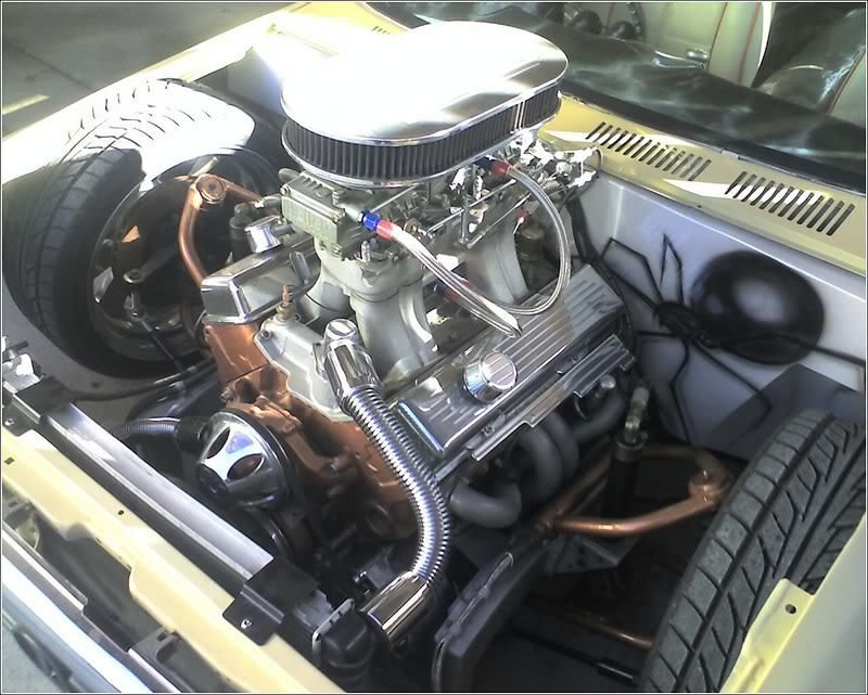

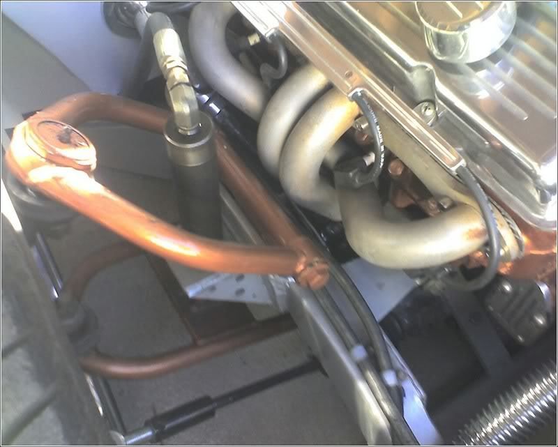

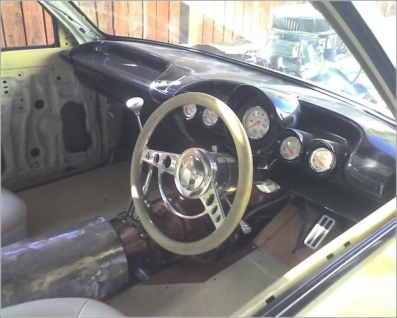

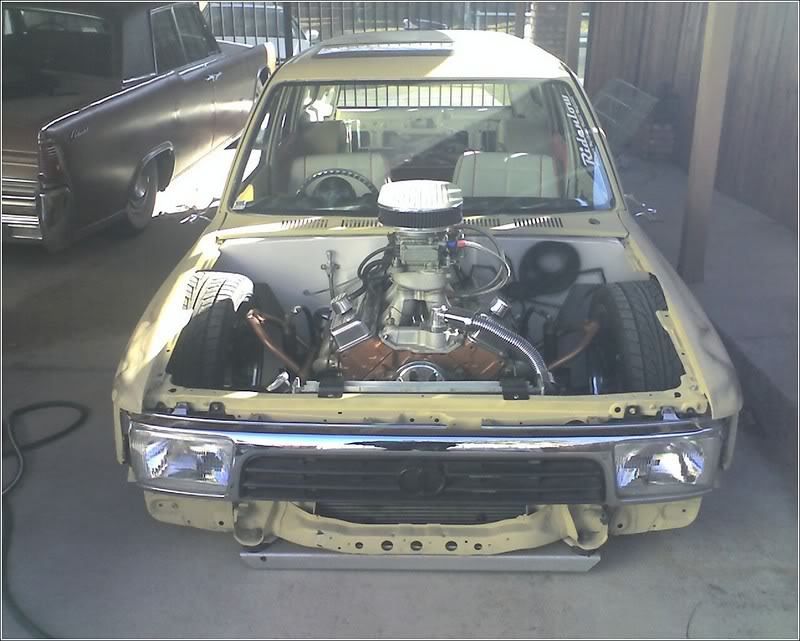

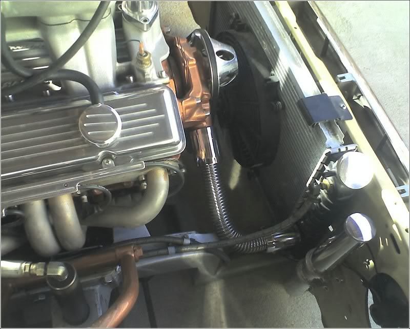

heres my 4runner, its actually pretty easy but you have to make a newtranny tunnel completely and the further it is set back the better due to the lesser amount of weight being on the front end. it does fit though/
tranny tunnel
