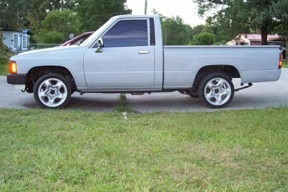

Well I just lowered the rear of my truck 3in Belltech Leafs and 3in pinion angle blocks
Go it all put together and the damn drive shaft hit the cross brace,The one under the cab, I had to notch it out box it in and weld it all up, Thought I had it done put it all back together and it was rubbing the lip on the gas tank...So Ibent the lip up and now it rides sweet, I will post some pics tomorrow I just got home from doing at the shop I work at

Yes it was worth all of it to have it slammed for SlamFest
Before any lowering
Rear Tire
Angle View
