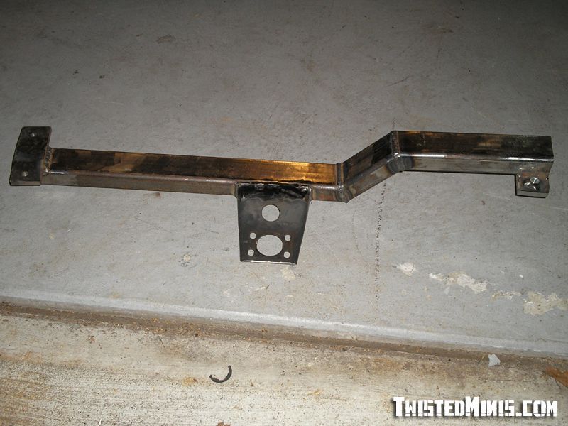

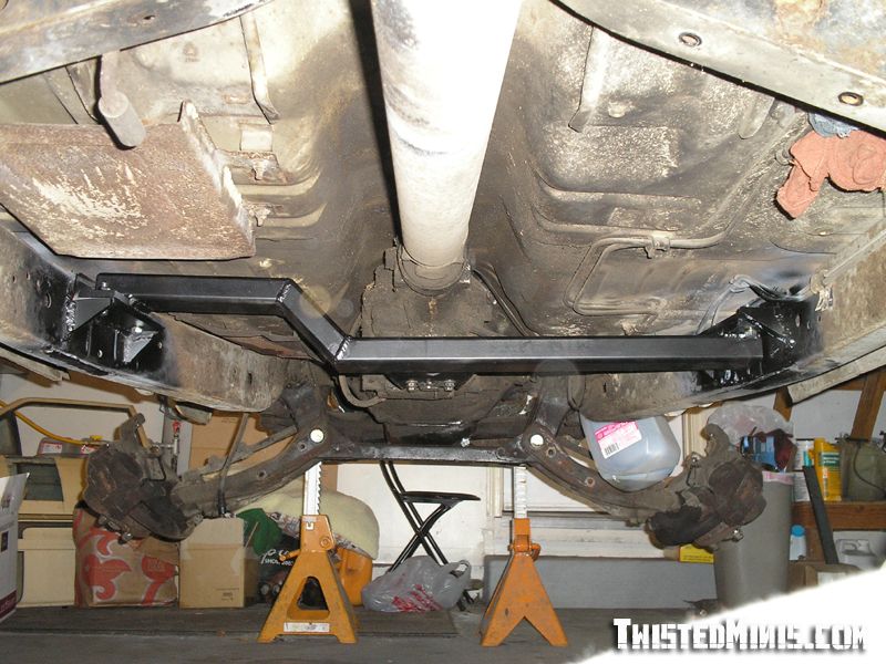

Heres mine.
Its about 1/4" off the ground. You need one if you want to lay frame.

DO I NEED TO Z THE FRAME ALSO? OR WAT? DID U MOUNT THAT TO THE STOCK LOCATIONS OR WELD ON BRAKETS TO A BOLT ON X MEMBER? ALSO WAT YEAR TRUCK IS TAHT 4? IT LOOKS LIKE MY FRAME BUT IDK...
twisted minis's avatar
twisted minis
You need to Z the frame as well to lay flat. The truck is an 80. The framerails are the same from 1979 to 1995. I welded on tabs. I'll be making those soon.

Seth, how much are those going for & is it a good investment even if not planning on layin frame?
twisted minis
I would say so. It would give better ground clearance. But if you're not bagging it, its a waste of money, because you would loose your suspension.
I will be selling them for $120 plus shipping when I get around to it.
