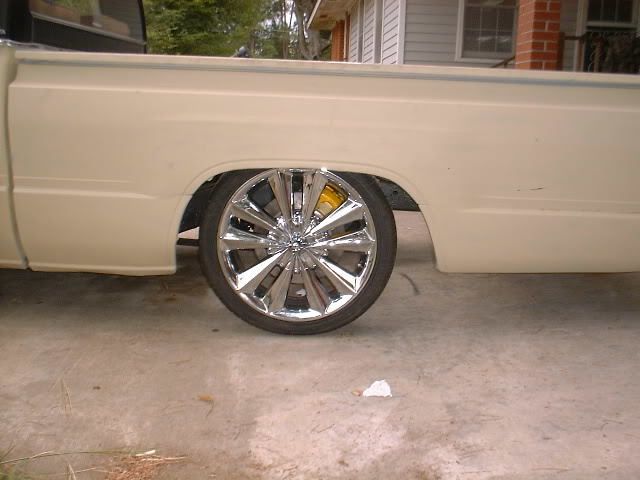

Hmmmmmm maybe I should chime in here for a little bit of advice.It took me two months to build my setup.Ok this kit I built is in negotiations with LC for them to sell it so I really cant tell you what parts it takes but I can tell you this.There are rotors that bolt exactly up to the yota pattern that work with the calipers.Yes the Monte carlo calipers are right but the discs are from a Ford product.Also the master cylinder has to be changed to a 4 disc toyta SUV,and you have to get the porptioning valve off of a older Toyota pickup that mounts under the master cylinder and the one in the rear is removed.That is about all I can say at this time but it kinda helps lead yall in the right direction,as for the bracket mine is custom made but it can be repeated.All and all I have about 450 in my rear disc brake setup and its to the quality of Downey.....Infact if this falls through with LC I might have to let the cat out of the bag.
