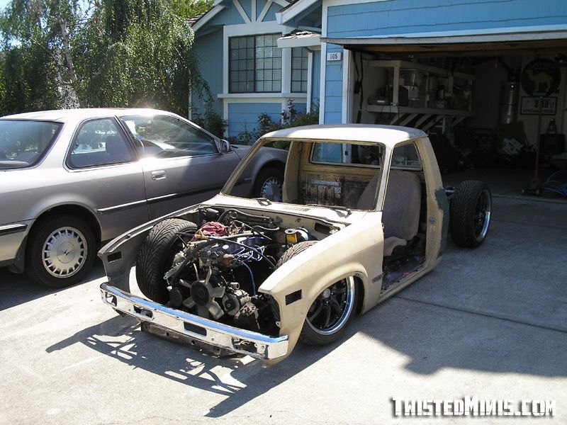

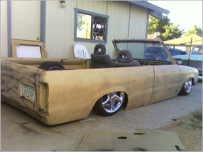

Glad some of you love the old school yotas!!!! I got a 82. Built mine 10 years ago as it sits and just got the engine rebuilt and decided to bring her out. Its got a 3 1/2 BD. Hydraulics, shaved everything. She will be getting a little faclift before Reso and a complete overhaul after.

Dude, sweet. I saw some tiny ass pictures of that on SSM I think. Looks different with the shaved bodyline. So you're bringing it to Reso? I'm busting ass right now getting my shit together for Reso.

Ya i have some on there.....with my wagon. Ya it almost looks like a new body style, kinda..lol. Im busting ass to get it going to Reso too!!! Have to relocate my booster and clutch still...And sand off all the rust.. She will look alittle ruff at Reso, but i dont care.... Its been rotting away for 10 years...lol

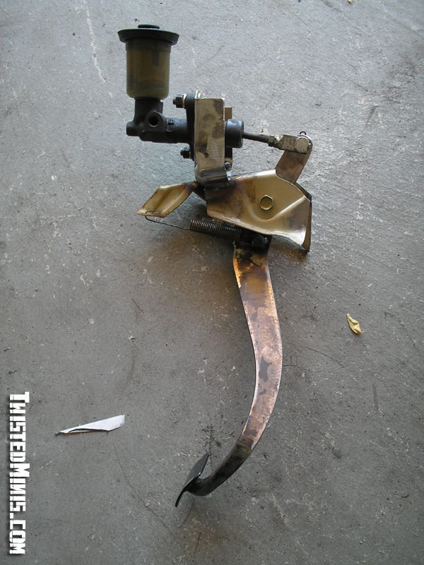

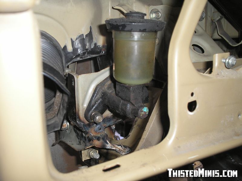

Booster and clutch master is easy. I have pictures of relocating mine if you want to see it.

Ya send me the pics!! The wheels that are in the pics are 17s. I should be going to Reso on 18s

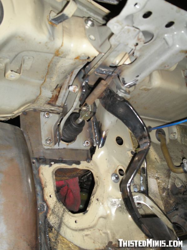

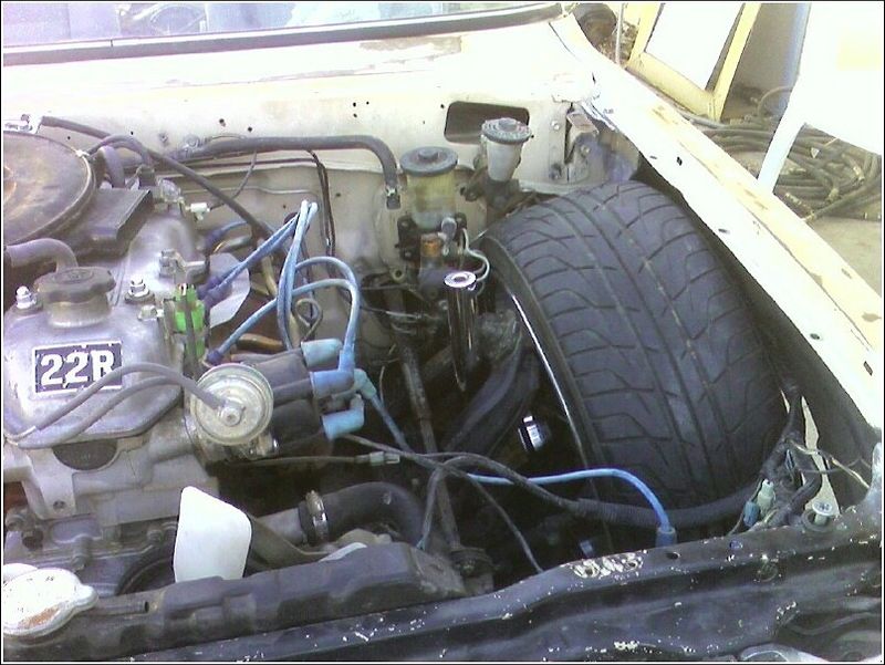

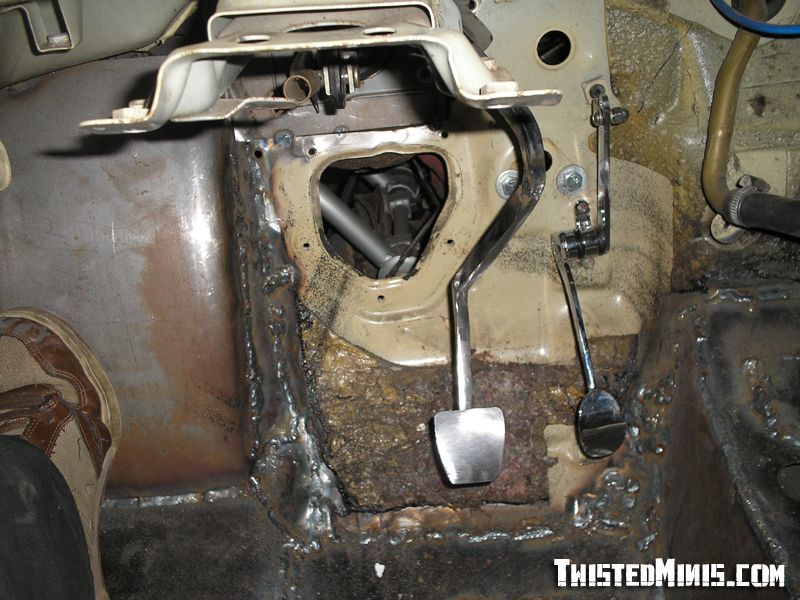

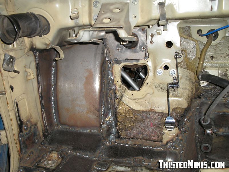

Here are all the pictures I have from when I moved everything.
I moved the booster up about 1.5" over 2.5" and out 3/4".

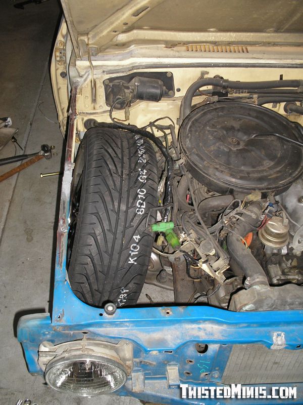

Can you really fit 18s in the front with that much bodydrop? I went 2 inches, and have less than a 1/4" before they pop out of the hood.
