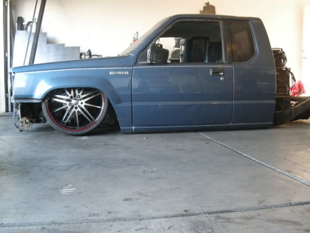

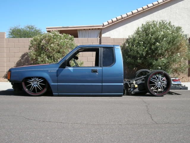

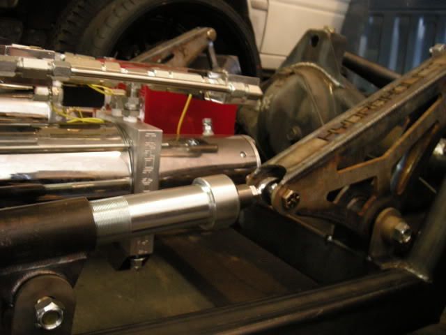

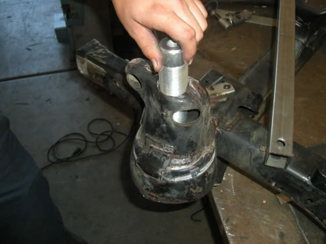

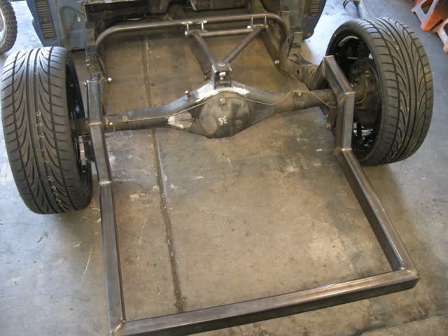

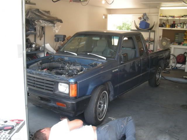

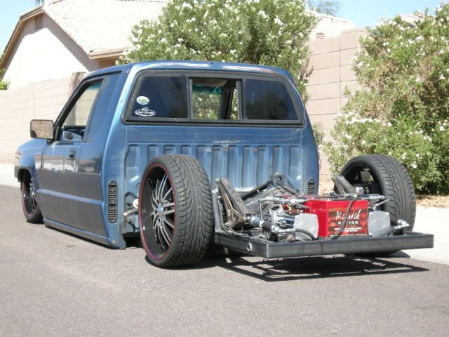

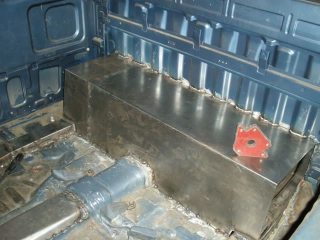

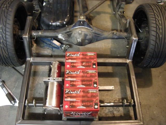

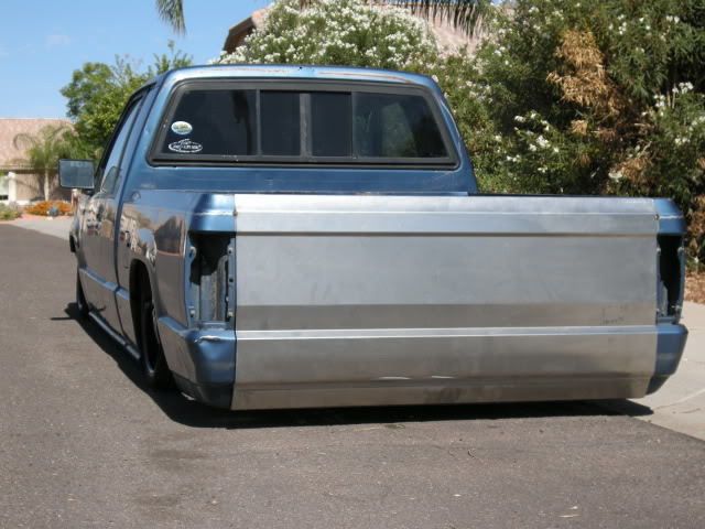

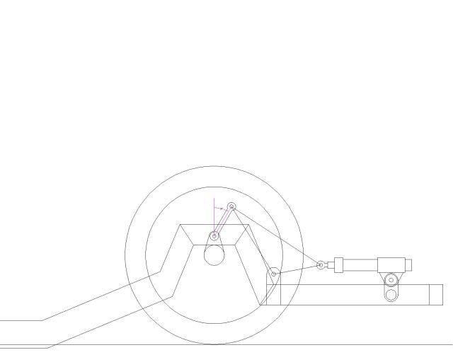

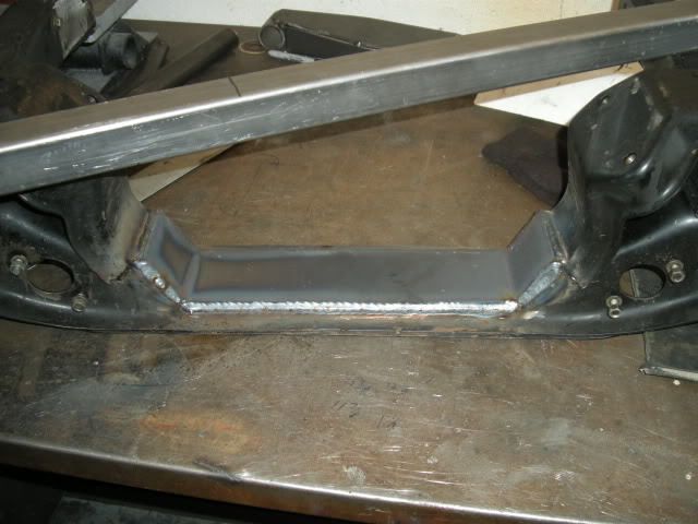

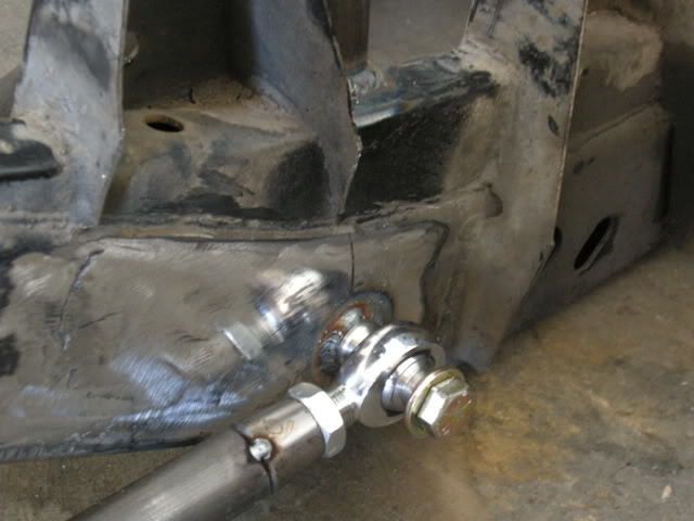

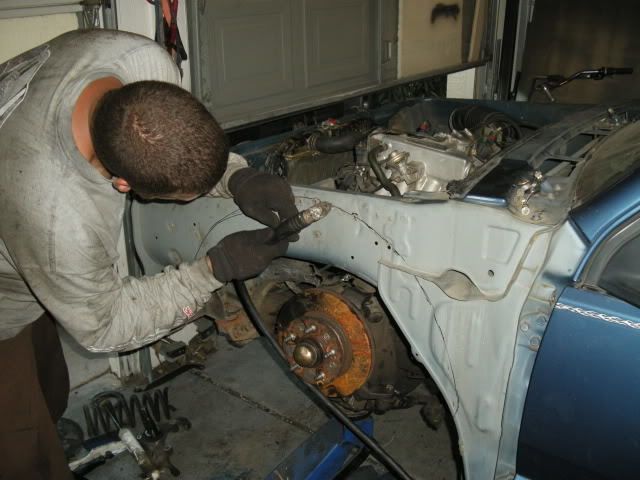

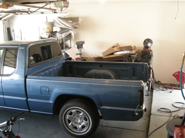

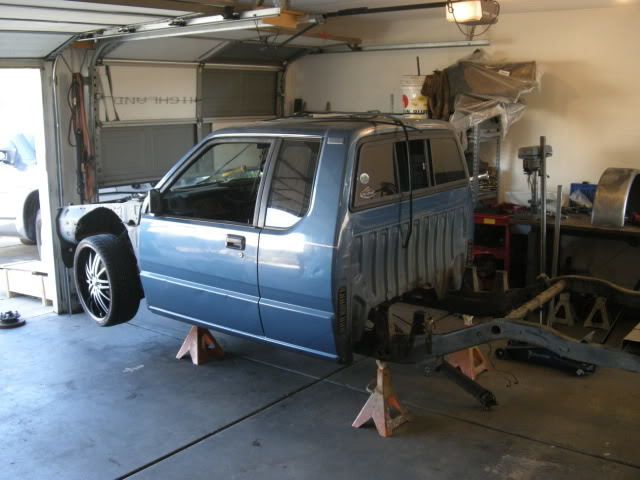

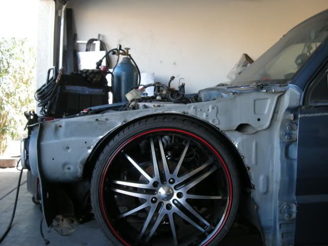

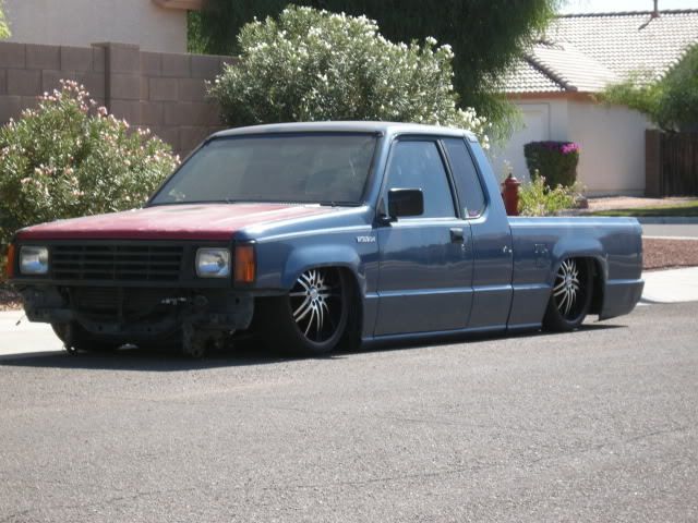

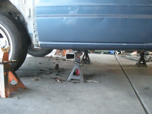

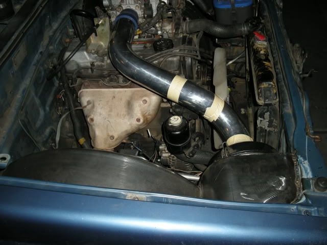

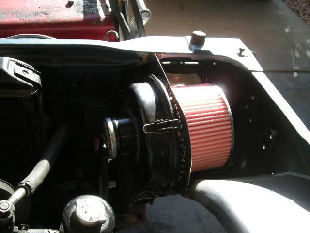

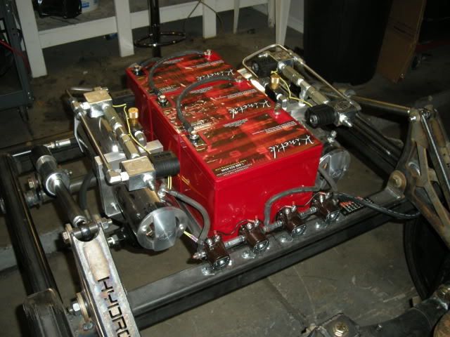

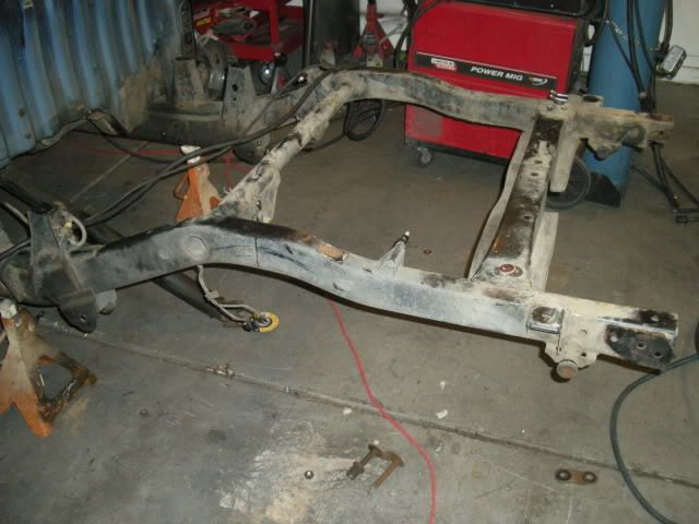

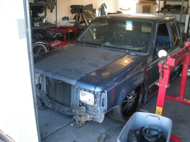

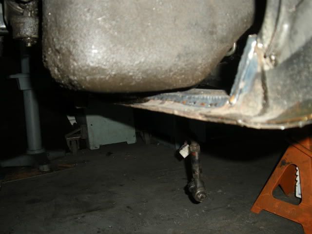

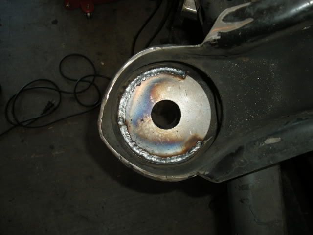

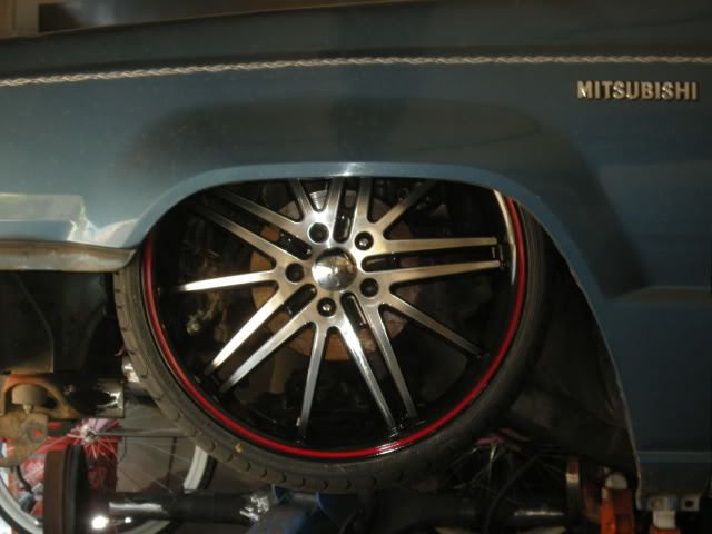

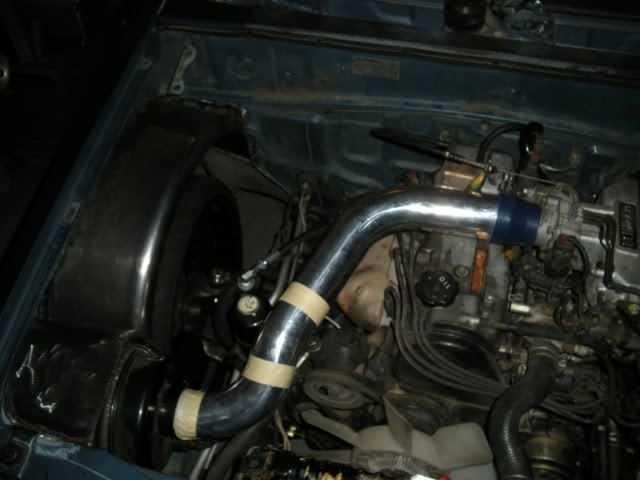

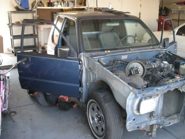

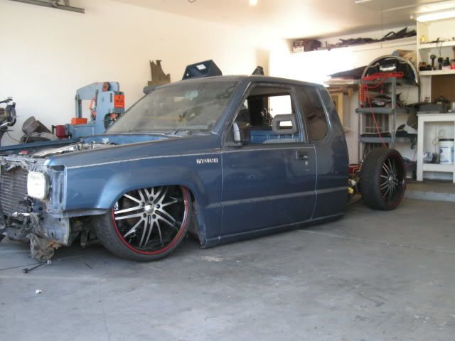

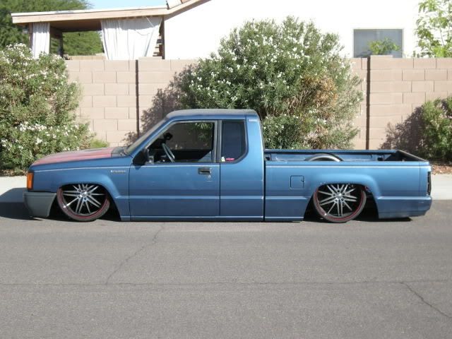

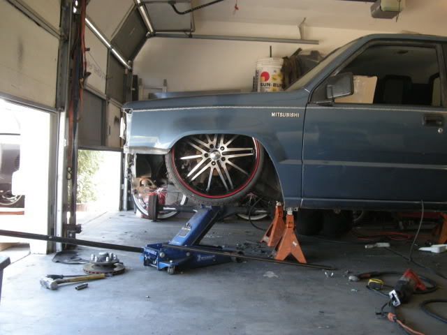

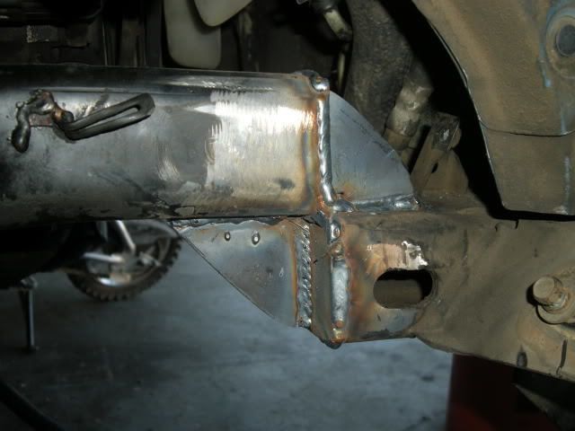

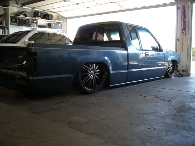

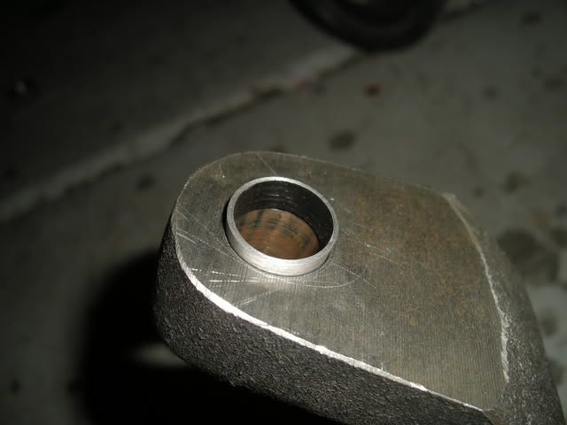

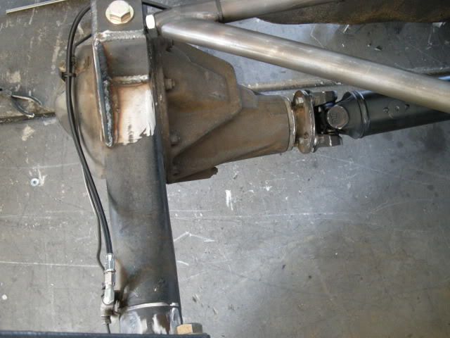

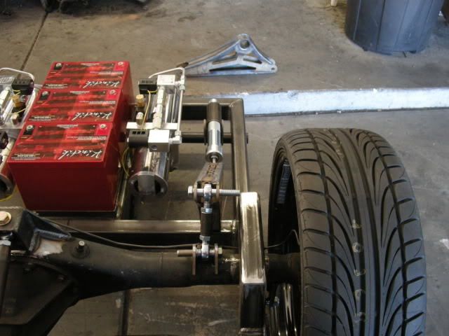

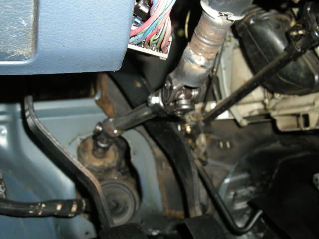

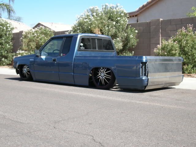

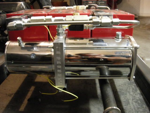

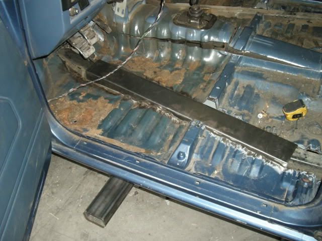

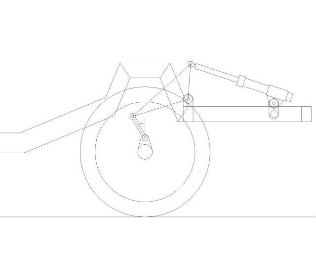

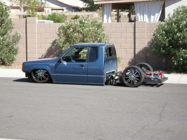

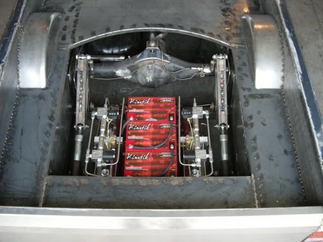

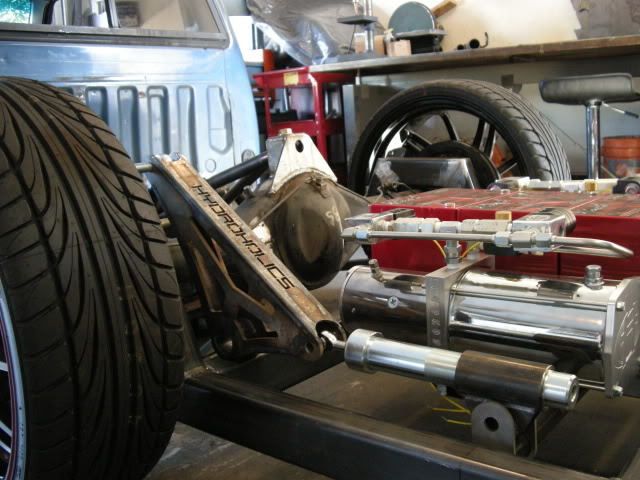

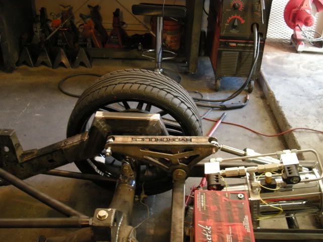

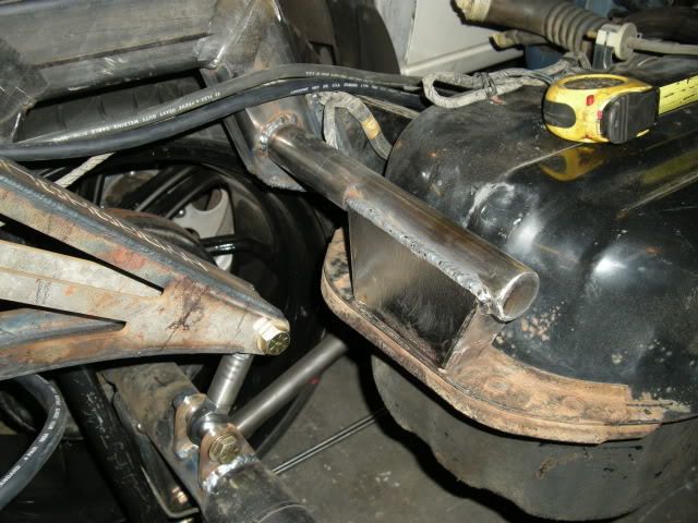

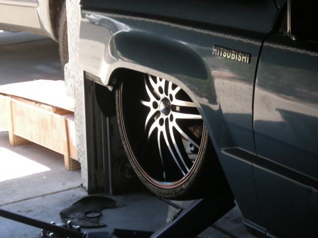

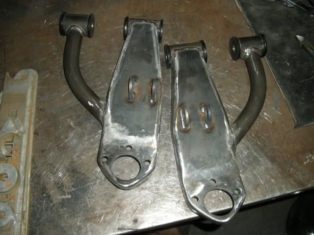

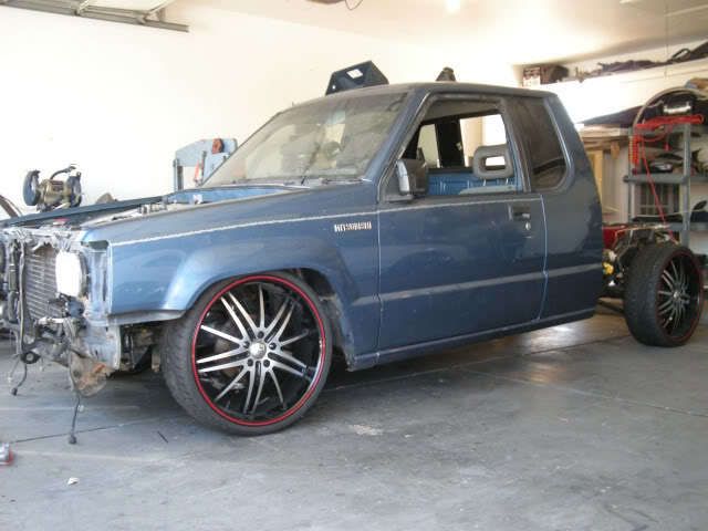

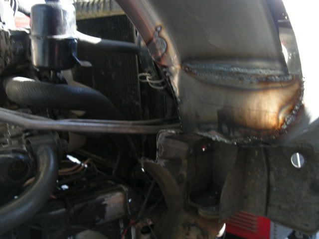

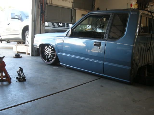

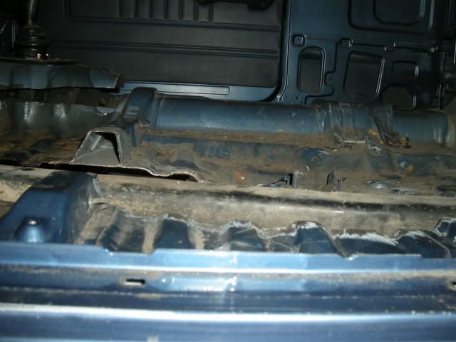

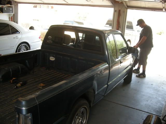

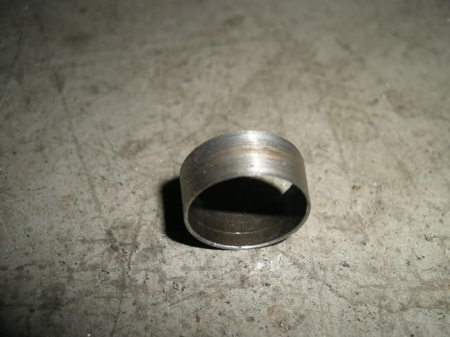

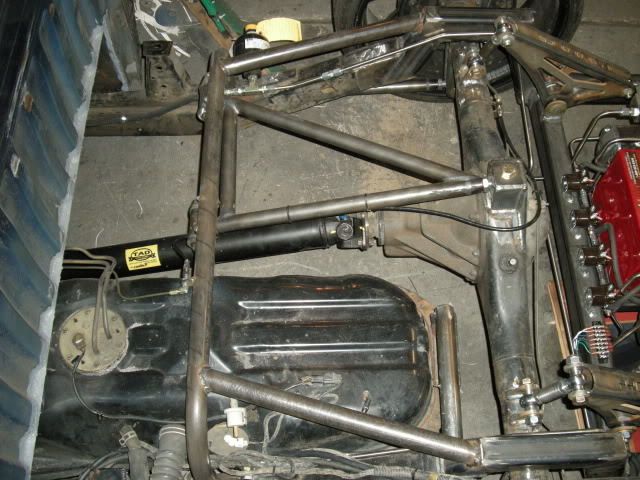

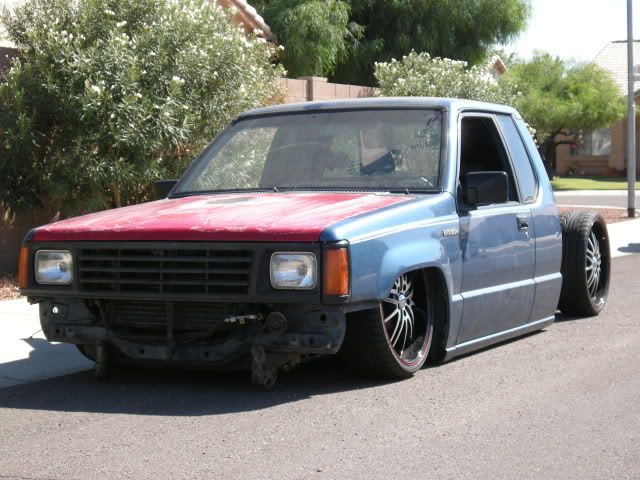

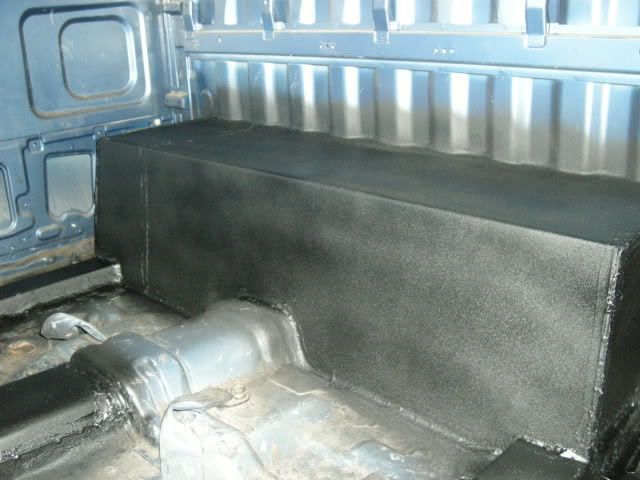

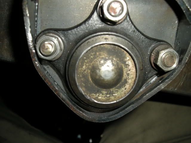

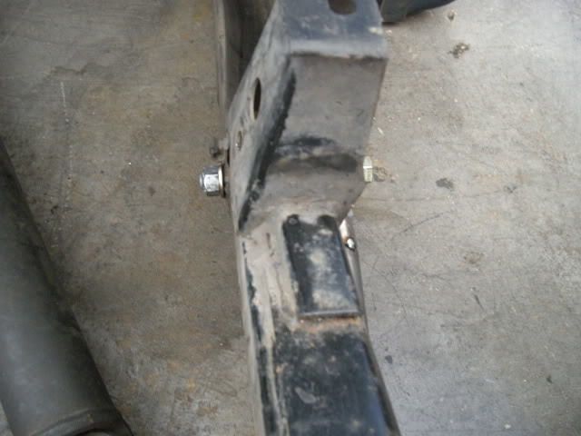

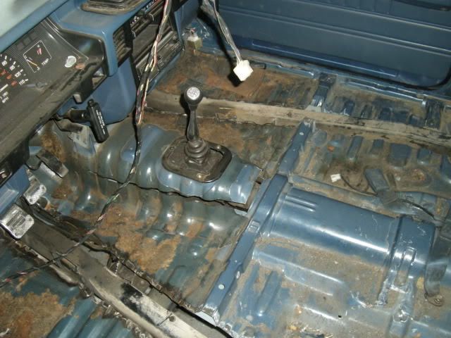

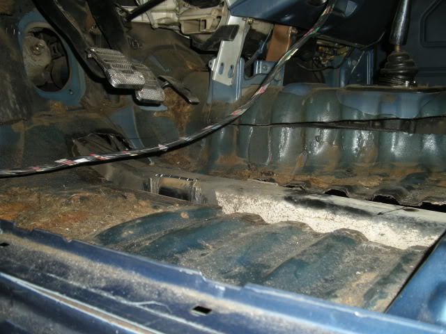

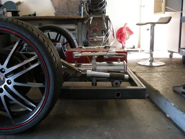

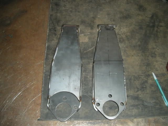

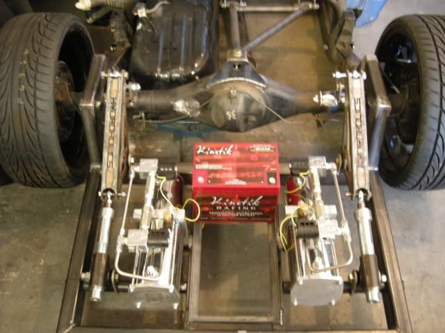

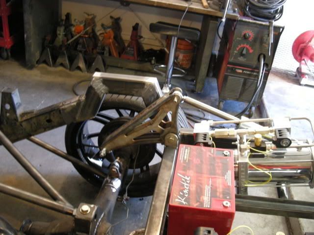

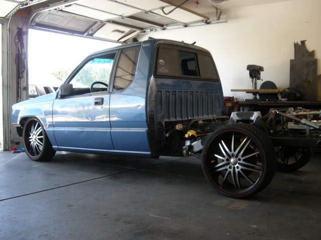

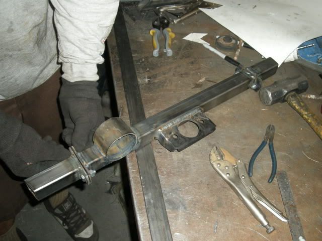

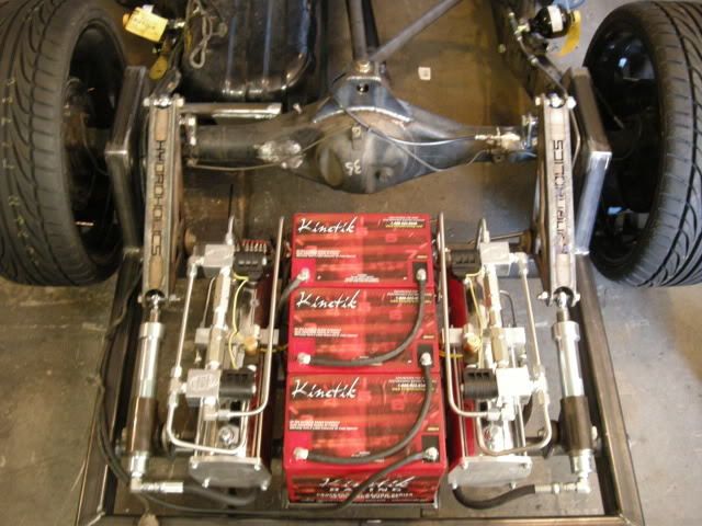

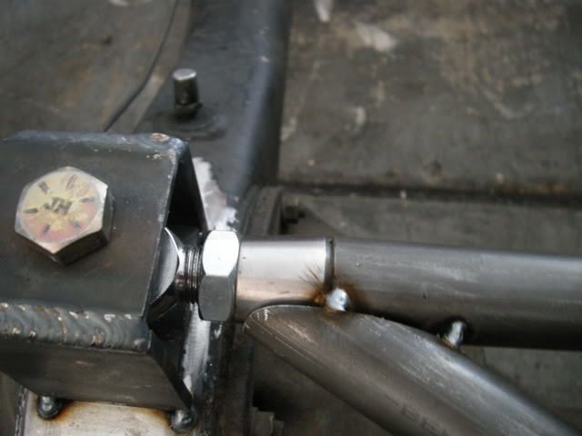

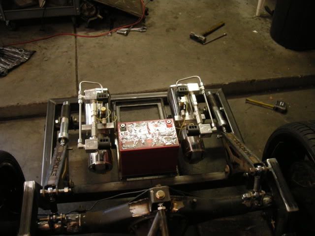

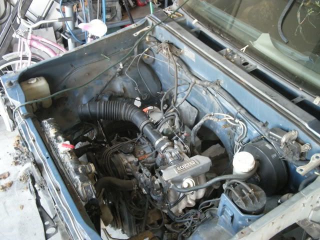

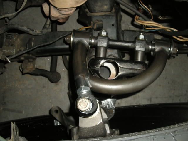

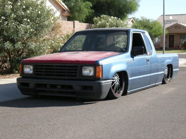

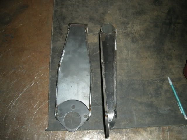

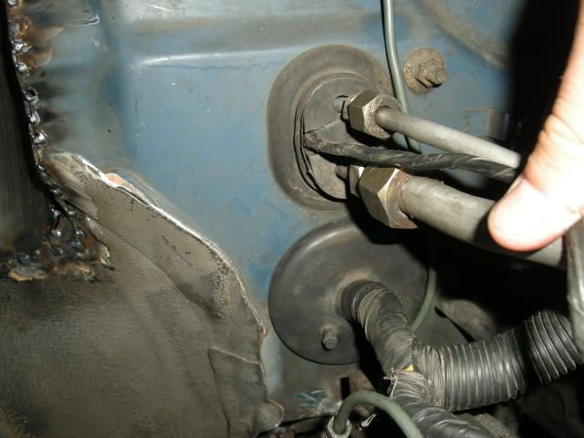

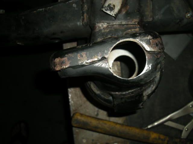

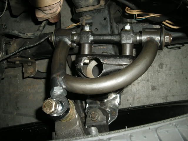

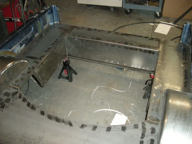

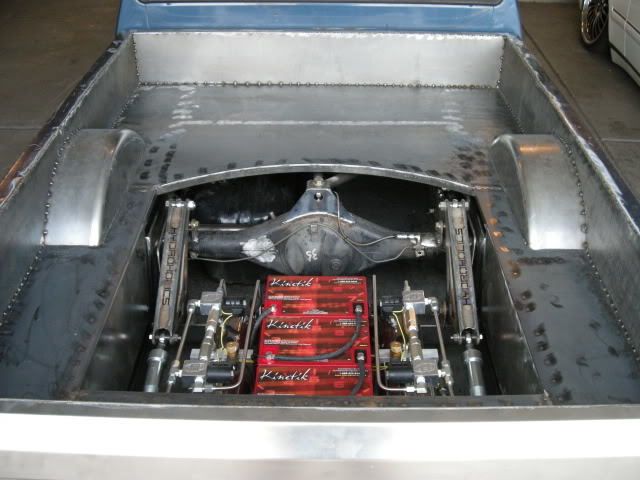

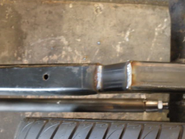

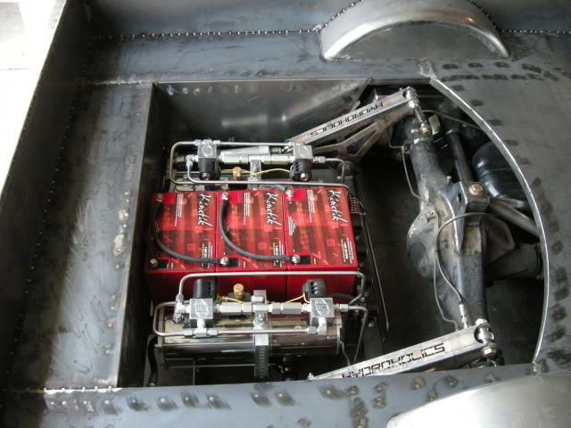

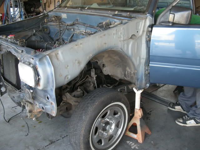

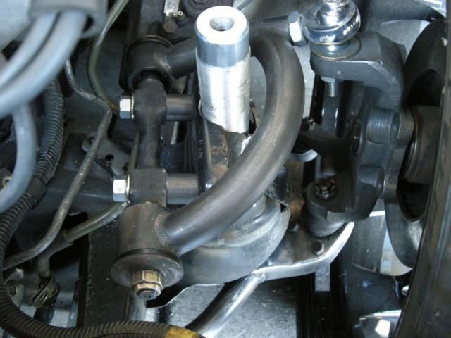

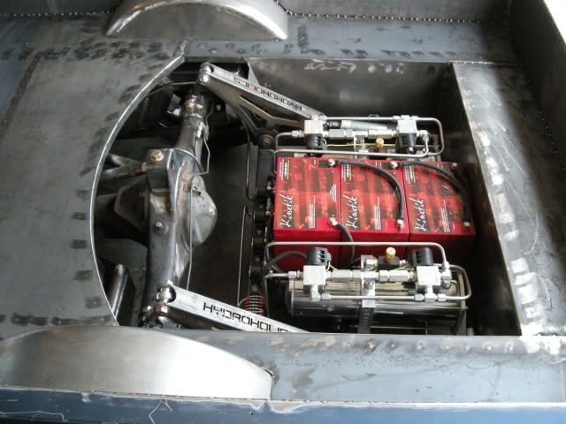

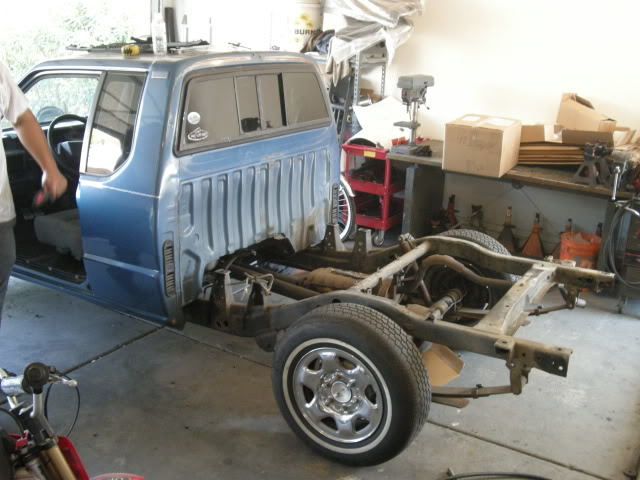

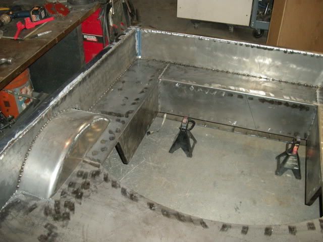

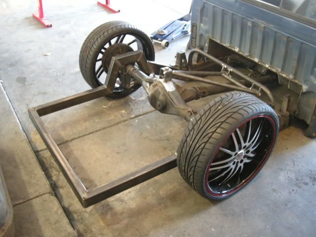

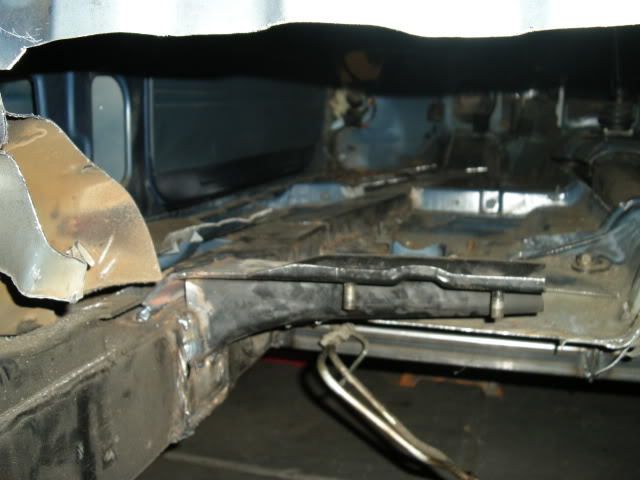

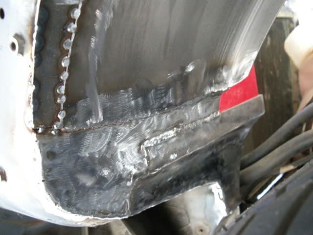

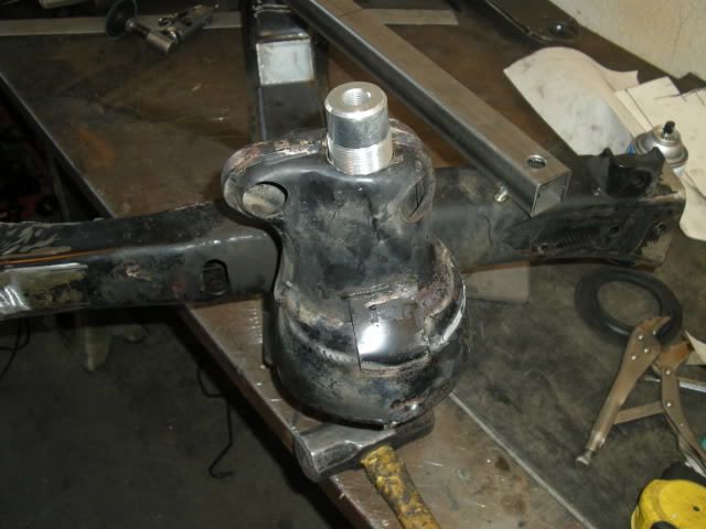

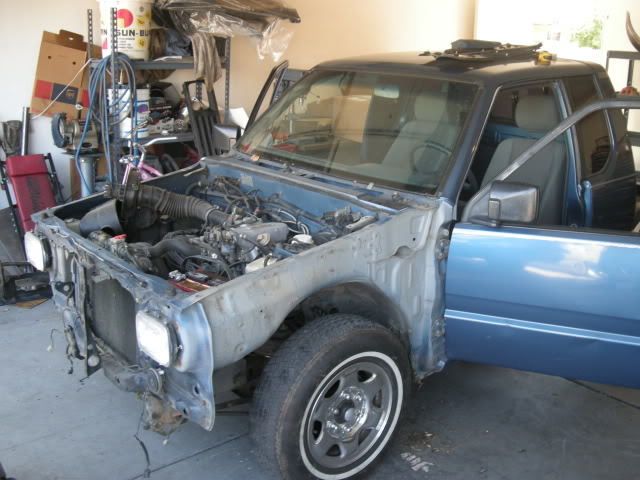

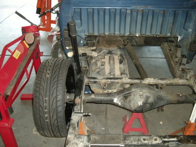

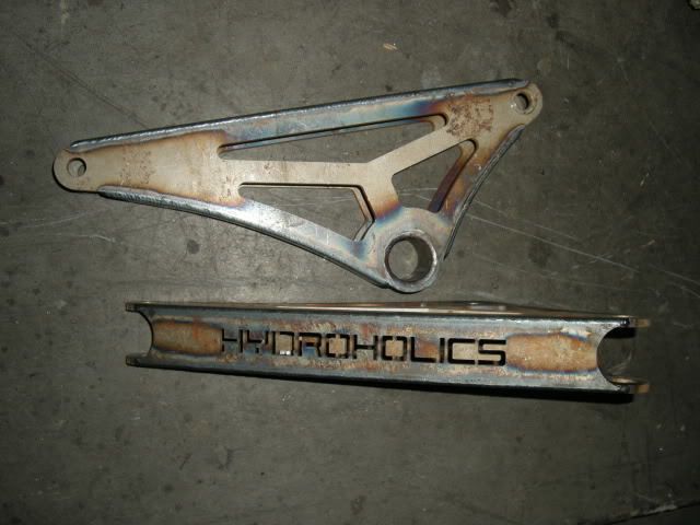

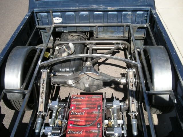

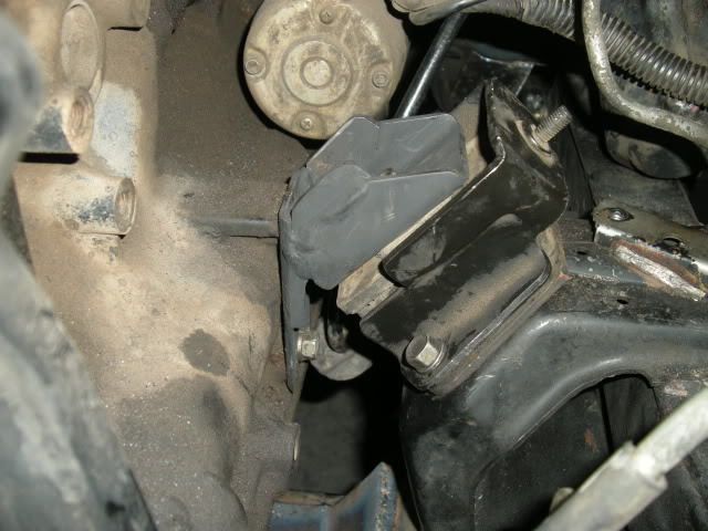

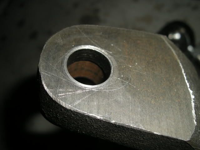

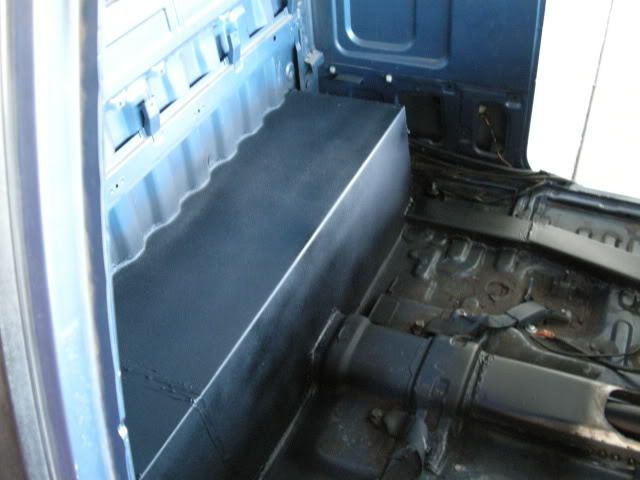

This is my forst post here, but I am a member over at MazdaBScene and IsuzuScene. I did a full build on my Mazda, and now it's time to build a Might Max for a buddy of mine.

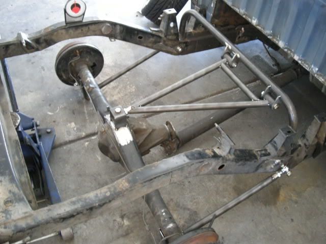

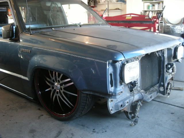

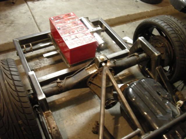

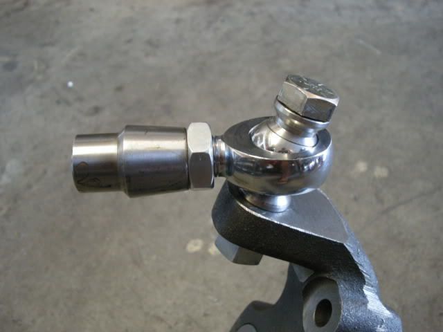

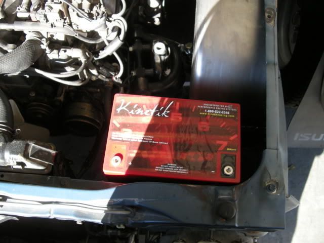

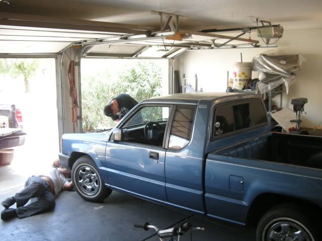

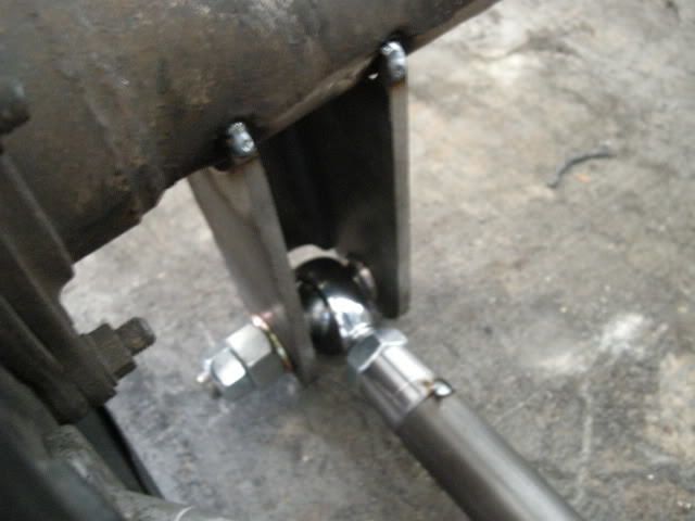

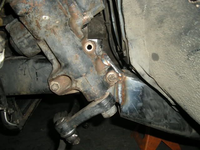

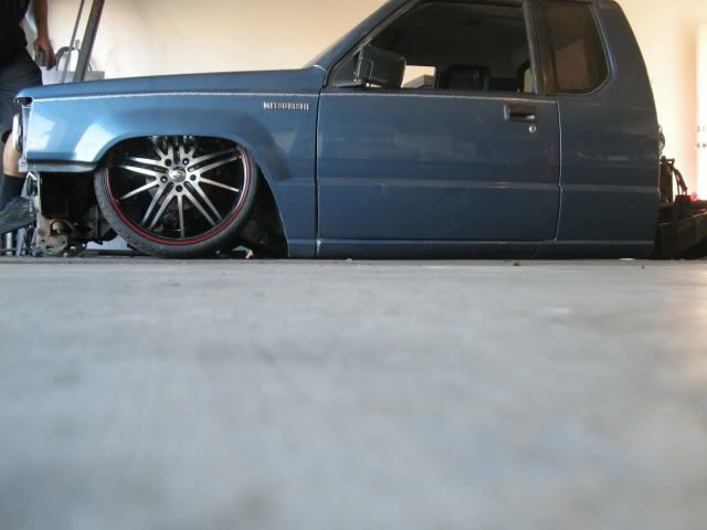

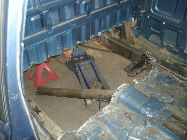

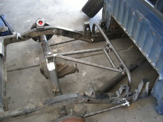

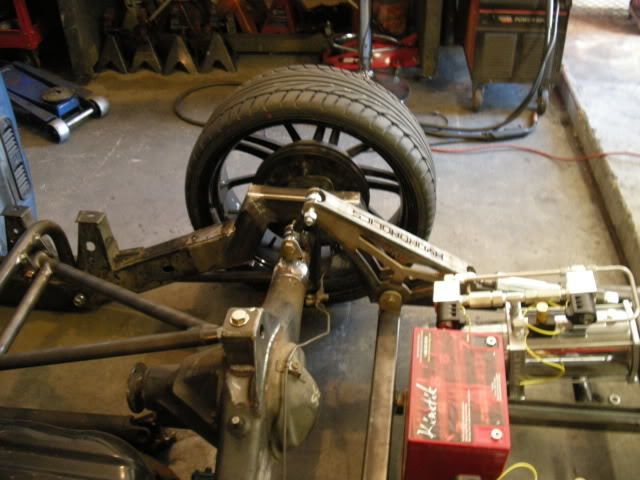

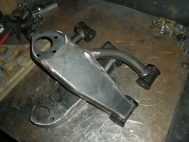

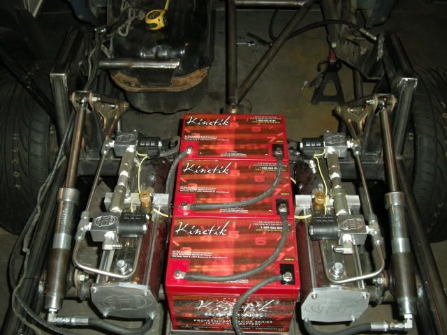

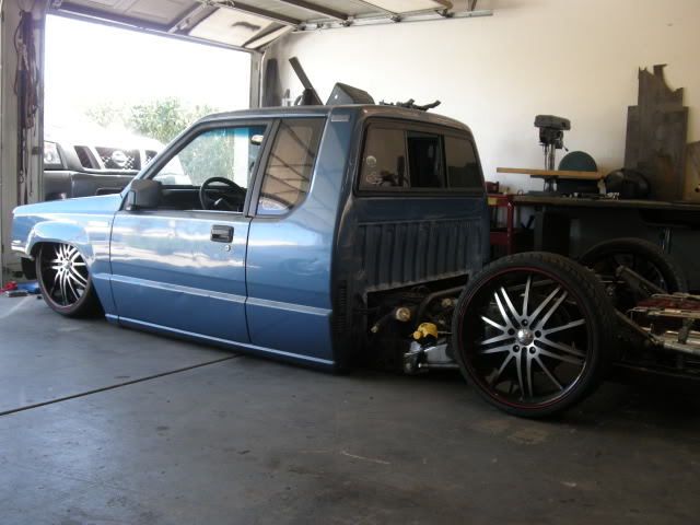

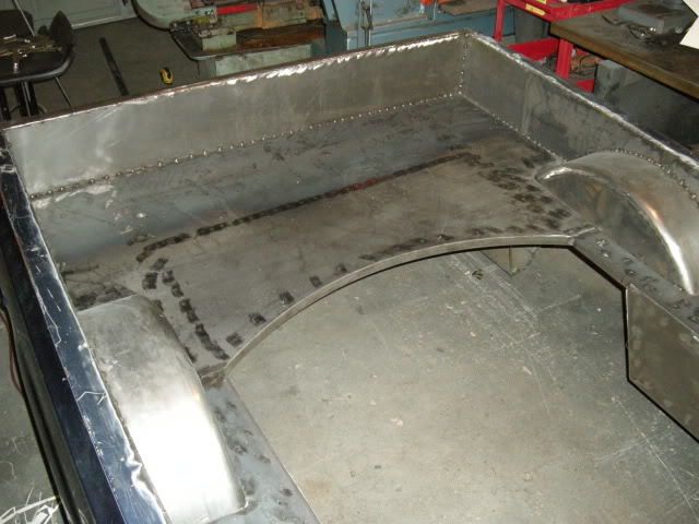

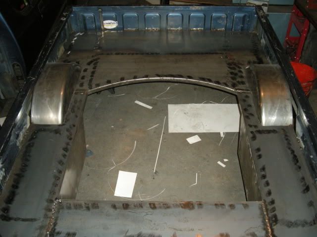

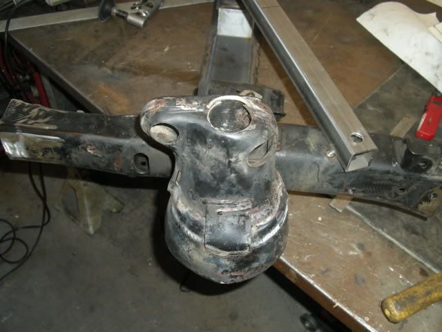

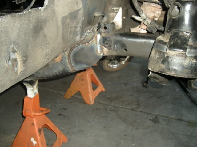

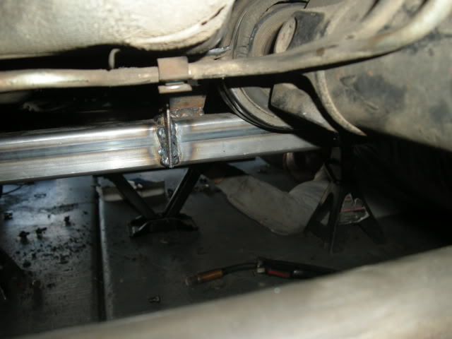

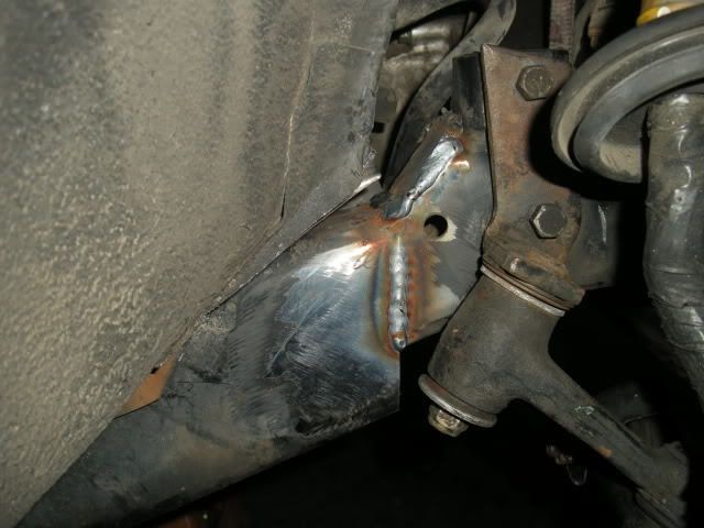

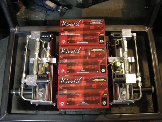

I am doing a channel for the body drop. The front gets new upper and lower control arms to narrow the front end 1". Also drop spindles from AIM and tacoma hubs, rotors, and bearings. The rear gets a toyota axle with a one off 3 link setup. I am doing a new frame from the axle back. The rear frame is dropped 3" below where the stock one sat. It will be getting a 2 pump 4 dump setup from Hydroholics.net with 4 accumulators. It will also be running 2 Kinetik KR2412 batteries for the hydraulics and one of the same batteries to run the motor and stereo. It will be keeping the stock FI motor. The rest of the plans are not finalized. Anyway, here are some pics to get up to date...
tre5
tre5
tre5
tre5
tre5
tre5
tre5
There ya go, now you are pretty much up to date. Sorry I didn't find this website sooner.

been following this on SSM. very nice work... I love the upper Ca's any intrest in making some to sell?

VERY NICE! Nice good clear pictures. I could have used some of these pics last winter when I was baggin my truck.
