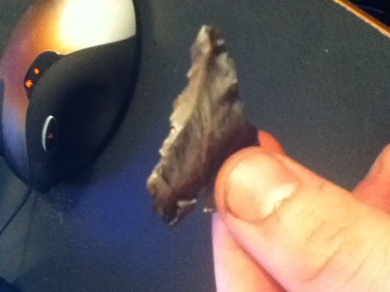

So I see there has been a lot of views but no replies. Pulled the valve cover off and it seems things will move when it barely turns over. Pulled the plugs and it still doesnt smoothly turn, and I cant manually do it. Really stressed that it could and more than likely seized. Dropped the oil pan and found this nasty thing....
So yeah. The hunt for the problem continues.

That looks like metal like probably part of a bearing or something?

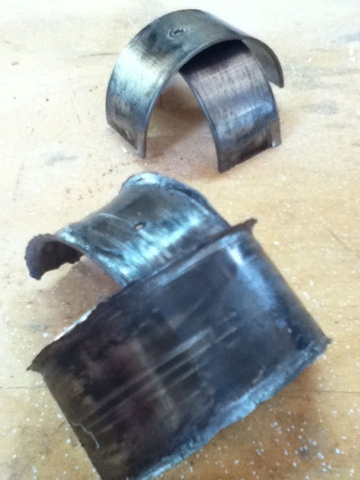

CORRECT YOU ARE SIR! Bearing piece. Ended up pulling the head off today, pistons looked good from the top. Pulled the front and bottom off and started to dismantle everything on the crankshaft. I thought the connector rod piece looked suspect but we decided to take everything out. Wasnt until we were fiddling with the 4th piston that we knocked something by accident and off flew a bearing. What do you know...it looked like these nasty things...I took a comparison shot..
So yeah once we freed them from the crankshaft the whole thing turned freely. Got some new ones on order, going to clean it all up, and hope it starts haha. I ended up ordering an old manual for it so hopefully it tells us all we need so that everything is synced right.
