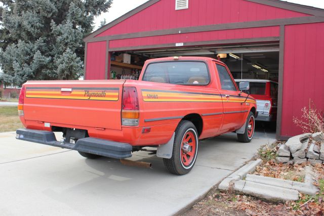

My head was cracked, and early direct replacement heads are near impossible to find, so I found a Conquest donor car to get a head from. As a bonus, I can also get the fuel injection and the turbo. This should be fun. I'll be keeping my build thread on my own website, but I'll keep you guys informed too. I haven't done much work yet, but my first post is up.
Any thoughts, advice, input will be great.
rxinhed
You'll need the block, ECU, high pressure fuel pump, exhaust refit, much electrical work and other things common with an engine swap...this is not all plug & play. Get the intercooler and everything else you can from the car, or the whole car, so you don't miss anything.
