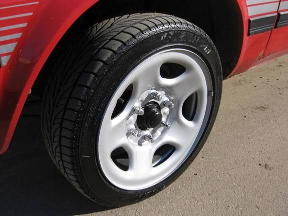

I'd say you have a ton of options, because the bolt pattern (on first gen trucks at least) is the same as a full-size Chevy. Before I put 18s on my truck, I went out and picked up some five spoke 16" steel rims for a GM truck. I got them at Walmart and they were super cheap! The center holes needed to be machined a bit, but that only cost me a couple bucks a wheel, so all-in-all it was a very cheap way to go! In my case I used a 205/45 Fuzion ZRi tire... But like I said, I'm sure you have a lot of options, this was just one that served me well. Good luck!

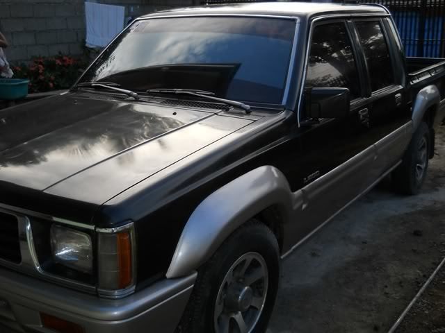

Hey man wear do you live thats only the second 4 door max ive seen ive never seen one in person tho...... it looks very nice and id go with 17in
maxxinn
That 4door is sic any interior pic?

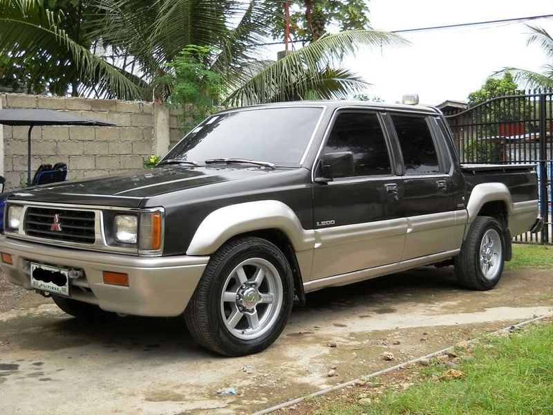

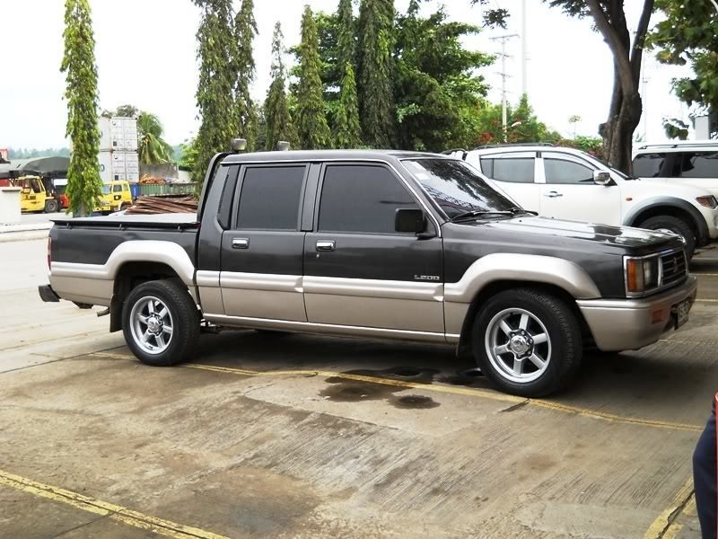

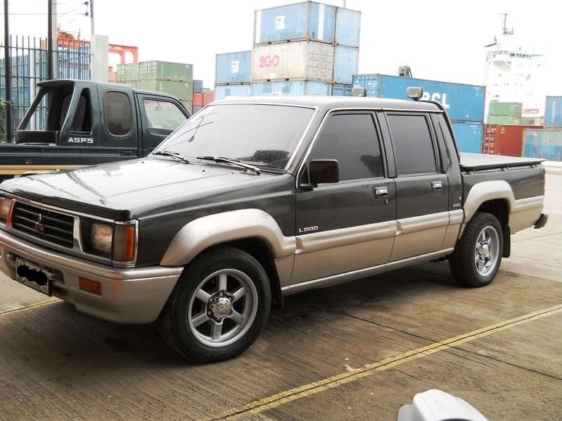

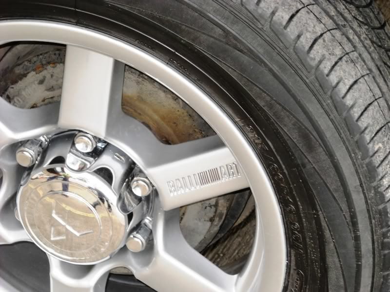

I originally planned to go with 17s as suggested, but when I went to the shop to buy some rims, I saw a set of Ralliarts and fell in love with it. Unfortunately, these were only available in 16", and was the last set.
I decided to get it along with some Yokohama 215/60R16 tires.
Here are some pics.

Those looks awesome on your truck.congrats
dexmax
Thank you very much. I am happy of how it turned out.
