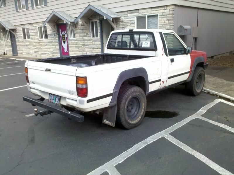

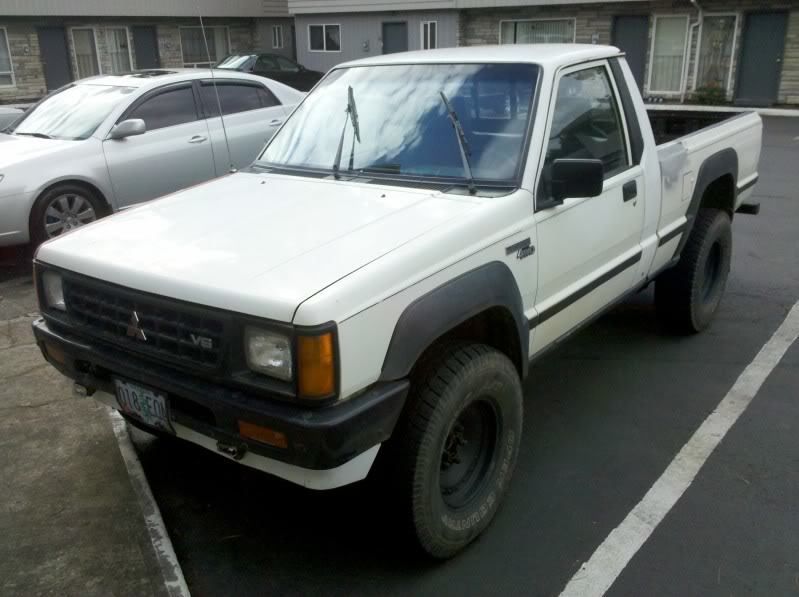

Hi everyone, I bought a 1990 Mighty Max about 2 weeks ago. My last car developed a Rod knock, so I parted it out and bought the Max for $500.
200K miles, 5spd, V6 4wd.
