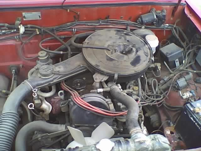

The engine wasn't bad, for a 4cyl, like I said:

looks like that might be an alright deal. that motor looks like a 2.0, if its an 87 the 2.6 would have a metal timing cover but im not sure about the 2.0s cause i havent had one or messed with any that age just older. might be a pretty decent deal though man if it runs n drives
