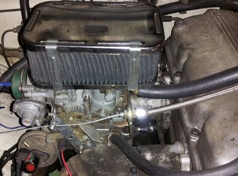

OK. Sorry mine is R6995, I think it's the same. Does yours look like this?

From what I can tell the holley 5200 is a copy of the weber 32/36 DFV model. I purchased a throttle linkage that bolt right up, and it looks like it belongs their just what I was after.
