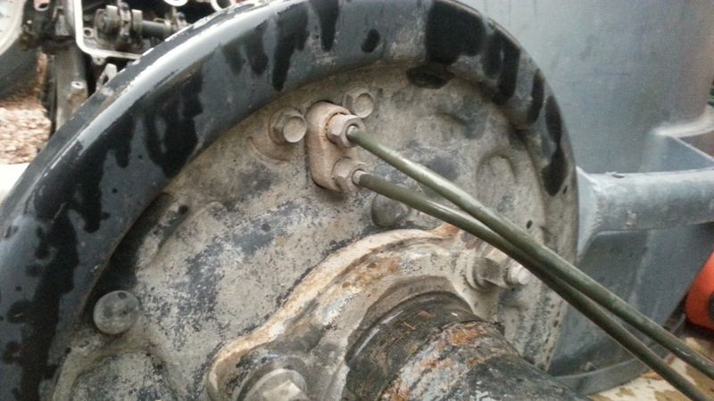

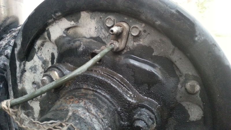

I was mistaken. The passenger side has the two hard lines. The driver side has the single bleeder.
Here are a couple pics of the rear that's sitting in my driveway.
Driver Side
Passenger Side
If the one in your picture doesn't look like my pics, you have the wrong part. This only applies to 86-93 B-series trucks. You are working on one in that range, right?

The images you posted don't work...but yes, mine is a '91.
The rear driver side has a cylinder, but the passenger side does not have one at all. I can get a pic of it up later.

Okay, one last try.
Driver
Passenger
Cusser's avatar
Cusser
Yep, that's how my B2200 rear wheel cylinders are, bleeder only on driver side. I'm pretty sure my rear wheel cylinders are original at 206K, but my front calipers have been replaced by rebuilt ones.

Okay, cool. I have the right one then.
