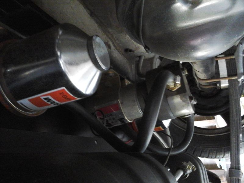

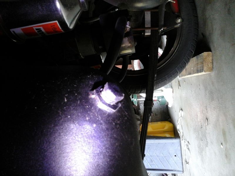

The car is not stock built 306 edelbrock heads, victor jr. Intake top with bg speed demon 650 cfm. Holley electric volumax fuel pump it 2 outlet and 1 return also holley fuel regulator has inlet and 2 outlet.stock gas tank with rear sump.my questions is the return line from fuel pump to the top of the tank. Will try to post a pic. Later

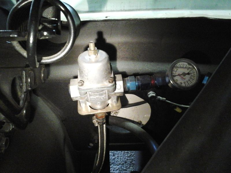

If it is carburated, the electric pump should build to pressure and stop, if not, you can add a power to the pump pressure regulator inline, no return line. Other systems TBI, etc, would not guess. Does not have return line originally. Originally fuel pump was on the engine, mechanical.

Fuel regulator and engine bay

Opps wrong pic. Still learning

Fuel pump
