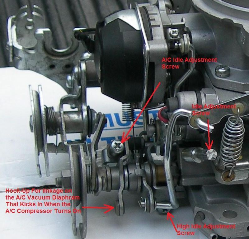

There is a High Idle screw on the stock carburetor (as well as the Weber) but if you didn't mess with any carb adjustments before the HG change, and it ran fine before that, then you probably have a vacuum leak somewhere. Might be a vacuum hose you didn't connect back up (look real good!) or the intake to head area has a leak, or if the carb was removed from the intake, then that area could be leaking.
Spray some carb cleaner around those areas and if you get a change in idle, then the area you were spraying when it changes is where you need to look closely at.
Here is a pic of the adjustment screws on a stock carb.........BUT, don't go turning screws until your sure you don't have a vacuum leak!!!
