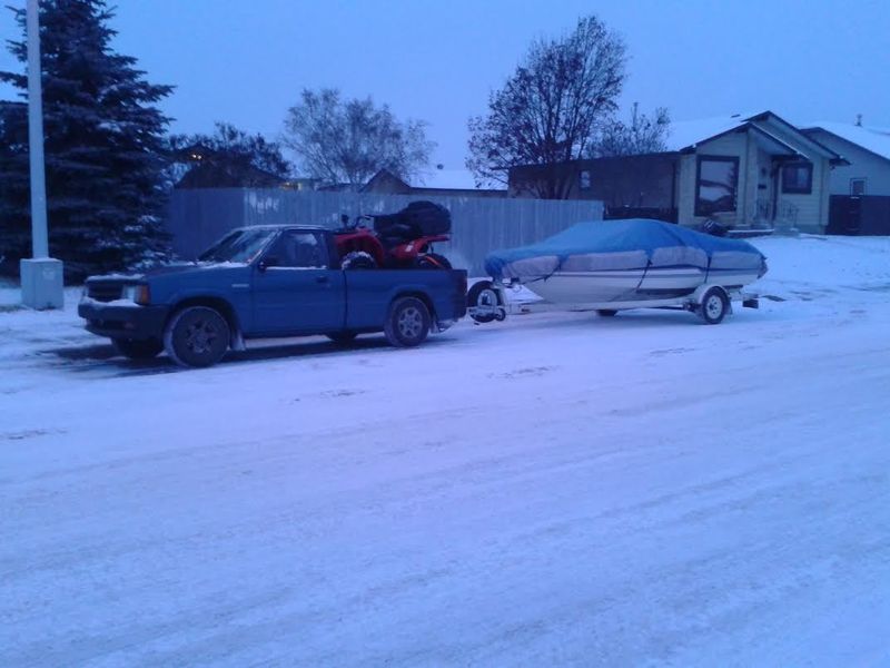

Did someone say overloaded? Lol
Went about 10KM across the city like this, tried to avoid stops as it was hard on the clutch to slip to get moving, and it was icy so brakes only really stopped the speedo from registering. I did out drag a minivan though, but I don't think they were racing. Yes, I was pulling the boat and the 4X4 quad.
Who said rotary's don't have torque?
Oh, forgot to add, the quad in the back is about 550lbs - 600lbs as it sits there, the boat is about 2500lbs, and about 10% (250lbs) weight on the hitch. My rear airbags are at about 110PSI.
