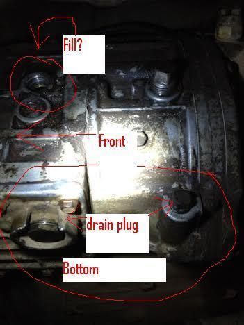

so im changing the tranny oil on my 89 b2600 (has 1990 trans) and i emptied the oil but now my question is which hole do i fill it with? its the 4 hole type tranny and im thinking its the top bolt? ill post a pic

mazdatweaker_2
If memory serves (it's been awhile) there is a bolt on the side of the case that you use to fill from the side. I's located n the driver's side (I think) kind of near the front and about 2/3 of the way up.

mazdatweaker_2
It's the square headed bolt (upper right hand in your picture) and no I don't know, but with the transmission level, you fill it until trans fluid comes back out of the plug hole.
tubs26
the one i circled and the one your talking about both have square heads. the one in the picture that is circled is about half an inch higher. I've already started filling from the one on the left. any objections?

scotch
No objection at all. That is the correct fill port. If you only fill the one on the right, you will be a little low.

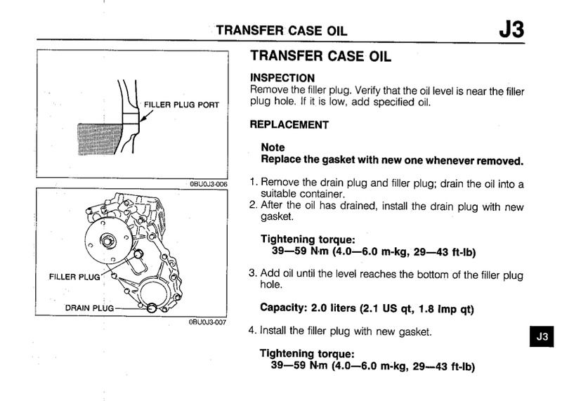

Tubs, don't you have a 4x4? If so, the transfer case is drained separately. Here is a picture from the manual.
Capacity is 3.3 quarts for the tranny and 2.1 quarts for the transfer case.
