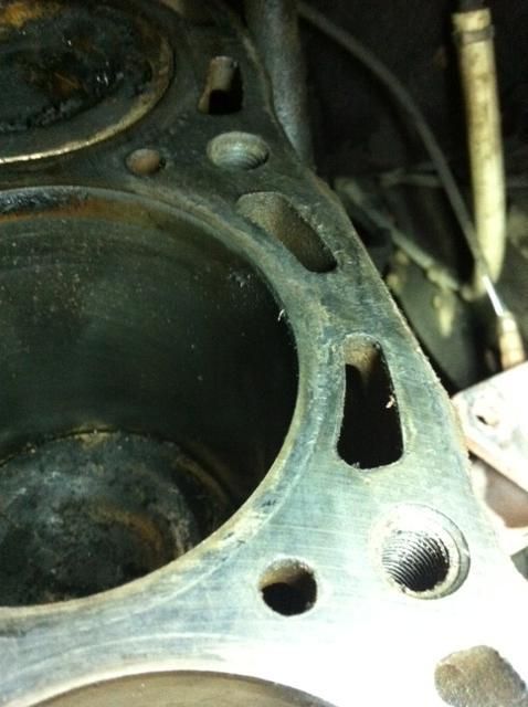

Anyways. I just finished cleaning the block and noticed there is some pitting on the exhaust side right where the metal rings should be. I can't get a feeler gauge in there, but I'd guess almost 1/32" in some spots. It's pretty bad on one cylinder. The others not so much.

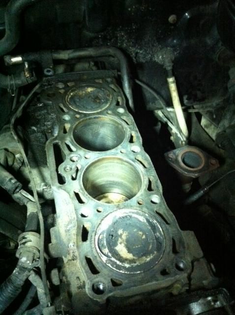

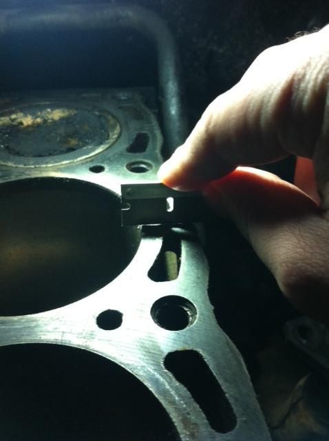

I took a couple pics. It was night time. I used a razor blade to show where the deck is pitted. The pic is of the worst spot. I'm debating finding something flat and sanding the deck. I have access to cast iron pieces, usually too large to fit in there though.
If I had to sand it down quite a bit, how important is it that i use a shim. I'm not interested in this being a performance vehicle but I want to take care of it. Would I have to use two head gaskets? One on either side of the shim?
