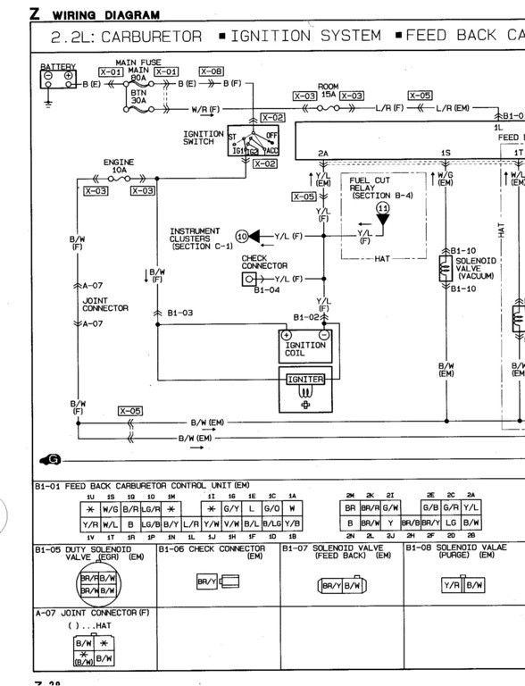

I have the distributor ready, new advance, new module, module coil, 900 ohm resistance. Now want to being sure of wiring for this. My manual is for b2600, 89 up.
Correct me if wrong , please. Remembering this is a b2200 distributor, I think the leads from the distributor go to the coil, blue negative? Other lead to the other post. New condenser on other post? Hot to the other post? Does this post go to ground? I have a spark plug lead plugged into coil, spark plug in other end, grounded to the coil negative side.
Do the distributor and coil need to be grounded? Reason for question, I have hooked the wires up like this, distributor out of engine and turned the distributor shaft, I have no spark. Twin tower air gap appears less that 1/16". I have the coil grounded and the distributor against this same ground. Help, ready to bscene.

As for the wiring, I can point you to the wiring diagram for a 91 B2600i which should be the same as your 93. Here is is...
" target="_blank" target="_blank
Below is a link of the wiring diagram from a 91 B2200 (carbureted) and you can see what the wiring to the distributor and coil looks like there and then figure out how to meld the two. "B" is black and "L" is blue.
Again, just to reiterate, I have can't speak to the compatibility of your 2.2 distributor in a 2.6 engine. So you're on your own in that respect.

Scotch,
Thank you for the response. I have it wired like this, but no spark. As before, not in vehicle for convenience of spinning, but all is grounded together.
2200 distributor has two lead not three, so it appears I can use the white and blue leads in the vehicle harness for power, when installed.
Wired:
Plus battery to b/w from module and + on coil. Negative battery to blue module lead, - on coil and spark plug base. Coil tower lead to spark plug end. No spark on spin of distributor shaft.
