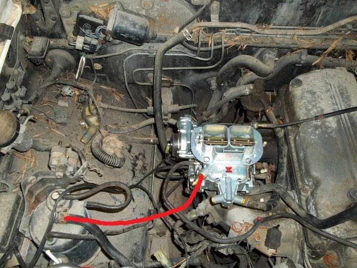

Send back the DGAV one. Not for our application. You want a 32/36 DGEV with electric choke.
Also pics so we can compare. Here is my 32/36 DGEV in the middle of install. The red line is where the canister hooks up.
If you have more question I cab get you better pics.
