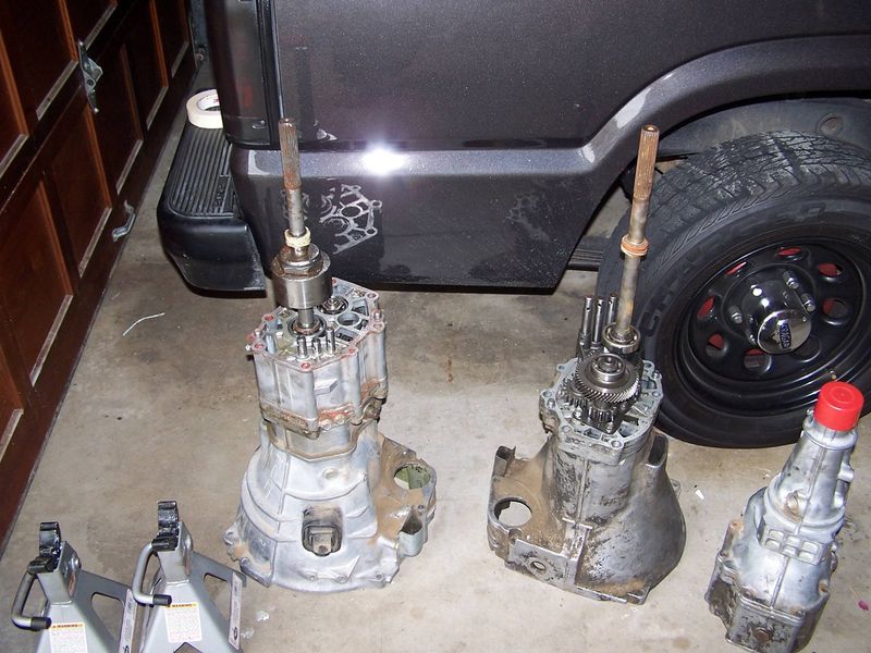

I did the 5th gear swap from an RX7 about 6 or 7 years ago and couldn't be happier with it. 2500rpm at 70mph.
pabartelt's avatar
pabartelt
whats the 5th gear swap? just swapping out the #5 gear and nothing else?
spacemonkee23's avatar
spacemonkee23
Yes, These are two RX7 trannies. I ended up using the one on the left with the big weight on the tail shaft because the right one had a very close ratio to the B... But this will help you see the exposed gear on the right is the 5th gear. center and tail shaft housing were removed to get to it and swap it out. This is the only pic I have left from when I did it. I will scrounge around to find another post I made somewhere that has the gear ratios for different year RX7s.
