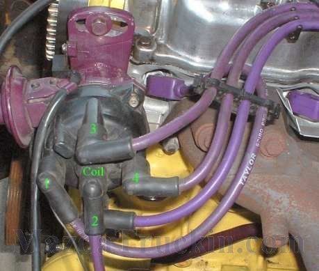

In the picture below, what's the little cap on the distributor cap between the #1 and #3 spark plug wire connections?
I replaced my distributor cap and that "cap for the cap" was gone from the original distributor cap so now I'm not sure if it just got lost and I should leave the cap that came with the new distributor cap on there or if I should take it off, or perhaps it doesn't matter?

the little cap on the distributor is so any moisture that gets in will get out.
cosmicsunset
that makes sense. I'll leave it alone. Thanks

That may be partly why it's there, but the main reason is just to vent the air. The nature of what happens inside the cap causes the air to become ionized. So why is that important information? Because an ionized atmosphere will allow the spark to jump around, and cause a misfire in a cylinder when the plug fires out of time.
