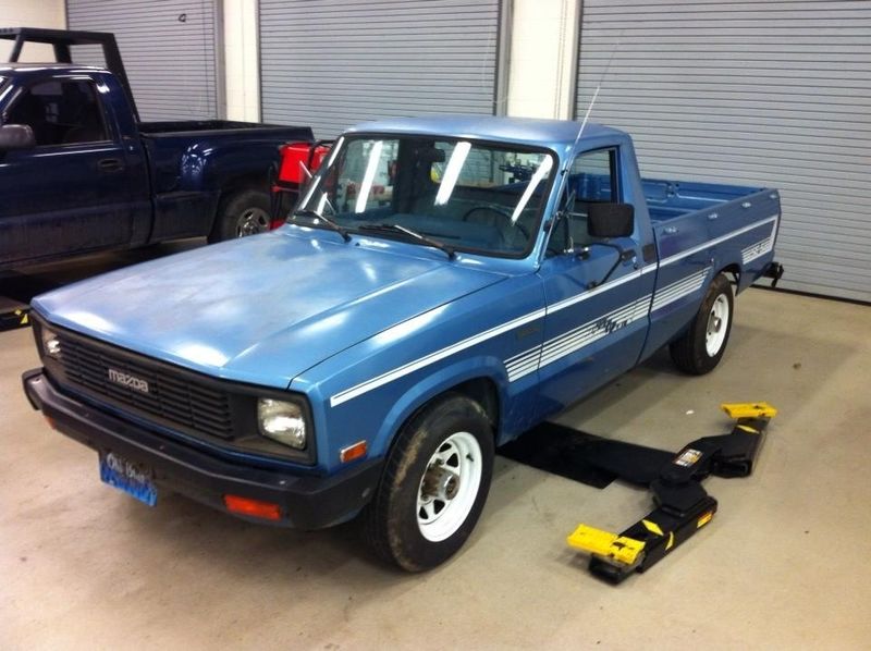

The trans is gone on my new 84 b2000 5 speed.
I read the trans write up on the "other" site, but have more questions than what was covered.
Can I use a later 85+ b2000 transmission by changing the bell housing? They are more plentiful and seem to be a better design.
If the answer is NO, then what specific year of miata trans will work? I know it says 90-93, but it also mentioned that some input shafts are longer - so is this the case with the miata trans?
Rebuilding my current trans is not an option, nor is replacing it with another 84 trans, as I don't want the trans failing due to age and design.
Thanks!
