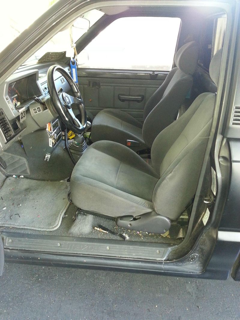

I have an RX-7 adapter in my B with my momo. I had to modify it a little with a stepping drill bit bec it didn't go on far enough to reach the turn signal pegs... Also I had to add a couple washers for the nut to secure it tightly. I've had it for 6 or 7 years now, works well.
'92 B2200 EFI... I finally found out how to use tapatalk!
lowlyfe's avatar
lowlyfe
Thanks guys. Spacemonkey, How many mounting holes does your momo steering wheel have?
spacemonkee23's avatar
spacemonkee23
My adapter is Momo brand for an 2nd gen RX-7 as stated above.
The steering wheel mounts onto it with 6 allen wrench screws.
Kind of hard to see in this pic but you get the idea.

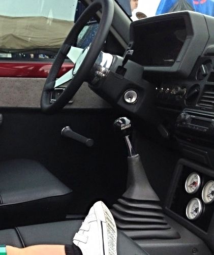

LeCarra makes a billet adapter but I had to order mine directly from the factory because they were discontinued at Summit Racing.
Best pic I have right now...

Thanks. It wasn't cheap... I think about $75. And the wheel was $157 from summit. Plus $30 for the horn button. It adds up fast... but still cheaper than Billet Specialties.

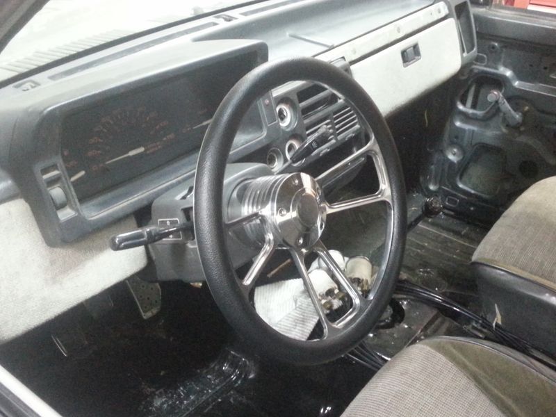

So after researching a little further I found that Mazdamn from here used an 86' Toyota pickup adapter so I placed my order through Ebay on blind faith and it worked. So anybody else in the future looking for a column adapter, the 86'-88' Toyota Pickup uses the same one.
