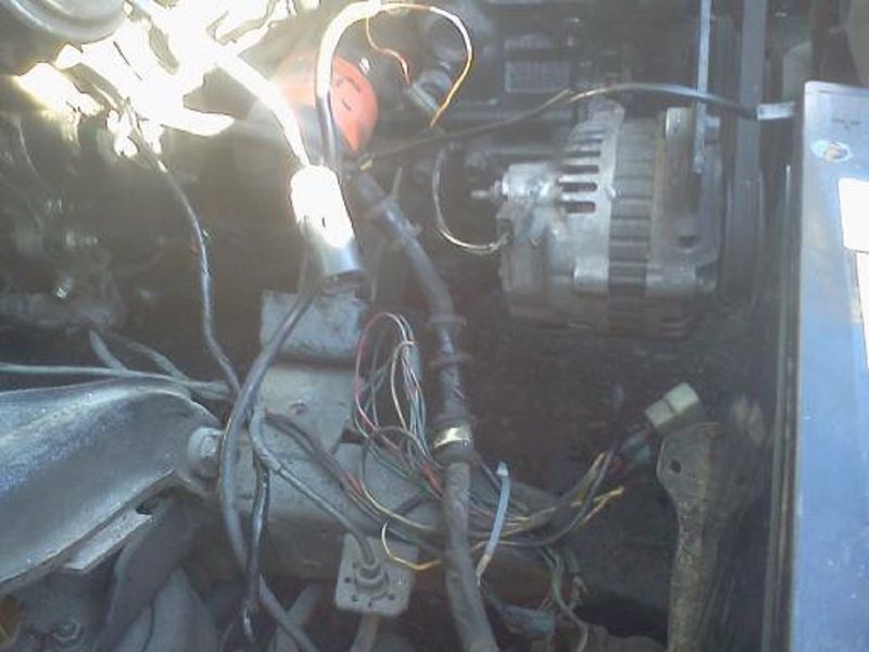

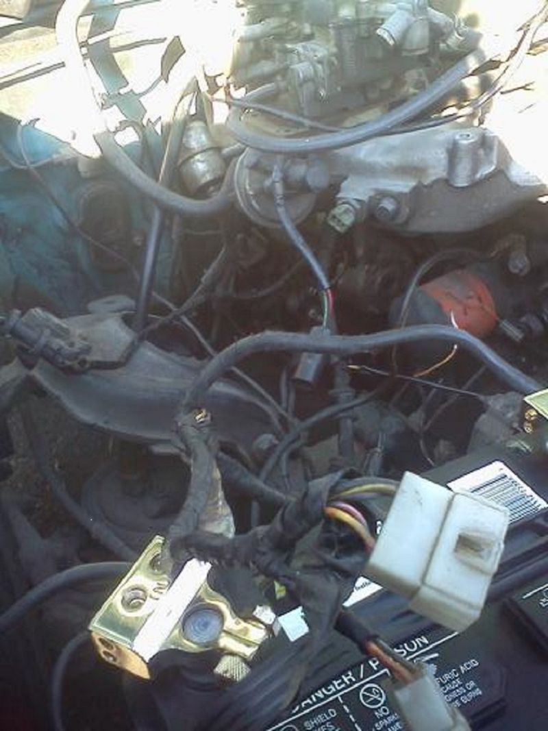

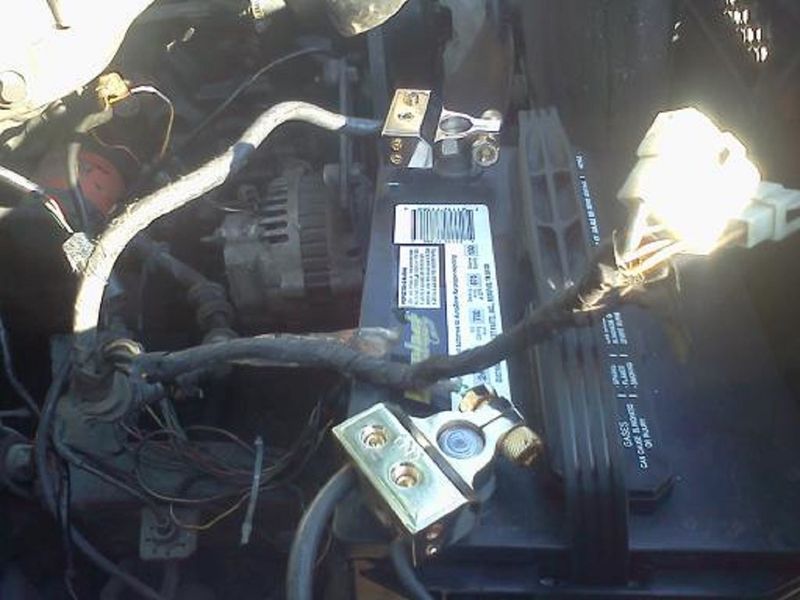

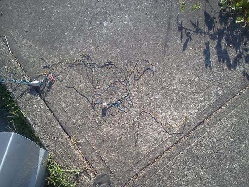

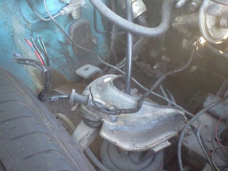

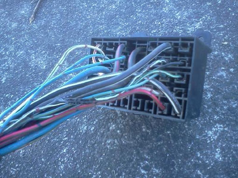

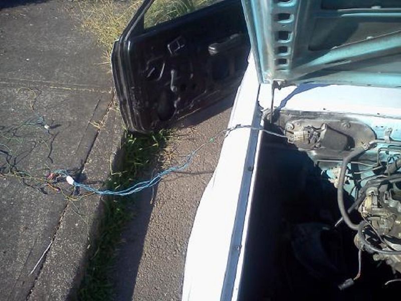

Finally had a chance this weekend to wrench on the truck, and with all the little bit of advice I had... got no where. I took a few pics to give insight into what I am dealing with, and hopefully it will help to get some feed back. So far I discovered that I probably need a new ignition switch, the power wire going into the switch could rotate 360 degrees, which Im assuming is no good... The new one that was purchased was wrong and the one needed was not in stock, so I will have to wait on that. got a new battery and new 30A & 80A fuses, and made sure all the fuses in the fuse block were in good shape. checked the power at the battery, 12.64V, and got the same at the back of the terminal blocks. checked voltage at the ignition switch, and none of the wires showed any power going to them. Checked to see if the headlights would come on, and they didnt. Below are a few cell phone pics of what Ive got going on under the hood.
bdroppd_2000
more pics
bdroppd_2000
some more pics
bdroppd_2000
i have a few more of the wiring harness but its kind of redundant. Basically from the looks of it the harness itself is not the problem, isa all the connections under the hood that are missing or damaged... Either way, I really need to get this truck rolling so any help is welcome.

Get a different harness! That wiring is a MESS! The pic you have on the back of the fuse block......has a fried wire coming out of it!! Someone that messed with this truck before you got it, needs to stay away from working on a vehicle for the rest of his or her life!
Start checking the JY's and get any of the harnesses that you can if you want to get this truck going again.......or you could unplug everything on this truck and just jump off the starter, hook up a power wire to the brake light switch (maybe the brake lights will work) so when you step on the brakes your brake lights come on, and drive it back to your house during the daylight hours and when there is no chance of rain.
Bottom line.......you need some good harnesses in that truck!
