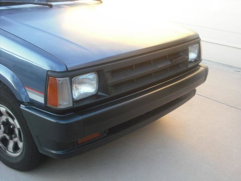

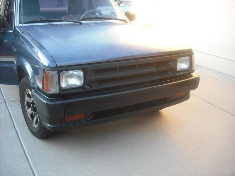

I'm planning on painting my grill and bumper this weekend...
As you can see it looks a little rough
What type of primer and paint would be best? I don't own a gun so it would have to be rattle can.
Do I need a different type of paint for the grill in contrast to the bumper?
Thanks
chaserjohndoe's avatar
chaserjohndoe
use a primer that works on plastic and metal. buy some red scotch brite pads, some light degreaser(pre-wipe), 100, 150, and 200 grit sand paper and maybe if its super rusty POR-50. If you haven't done a lot of painting look up some vids on youtube to get the general idea. and if you mess up you can always repaint it. Also and this is the important part do it above 65 degrees and if you are doing outside make sure it isn't gonna rain.

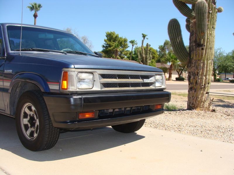

I painted my bumper, bumper ends and lower grille a few months ago. I used Krylon Fusion (made to adhere to plastics), no primer or sanding.
So while contemplating getting a black upper grille for mine, last Saturday I decided on a whim to paint the upper grille the same way. I had decided to make the headlight surrounds black. It seems to me - from looking at the underside- that the grille was originally a dark gray.
I'll either leave the emblem black, or paint the letters over with a brush. Maybe some automotive touch-up paint will work, those come with a small brush.
rcogan
that bumper looks like it came out pretty good...grill doesnt look to bad either..especially for a rattle can

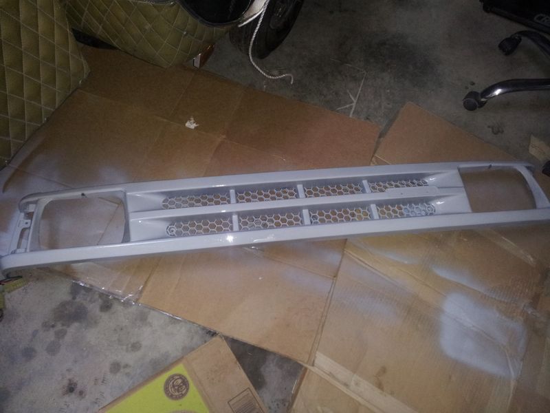

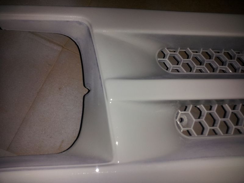

I used rustolem satin black on mine. (it's all in had and I was broke!) my grille started out as peeling chrome and after I took a razor and a dremel to it I primed it with rustolem primer and then filler primer and then 2 more coats of regular primer then I sprayed it with the actual paint. I put down like 6 coats all together and it turned out okay...
Primed
Close shot (I wetsanded it with 400 then 800 then 1000 grits)
