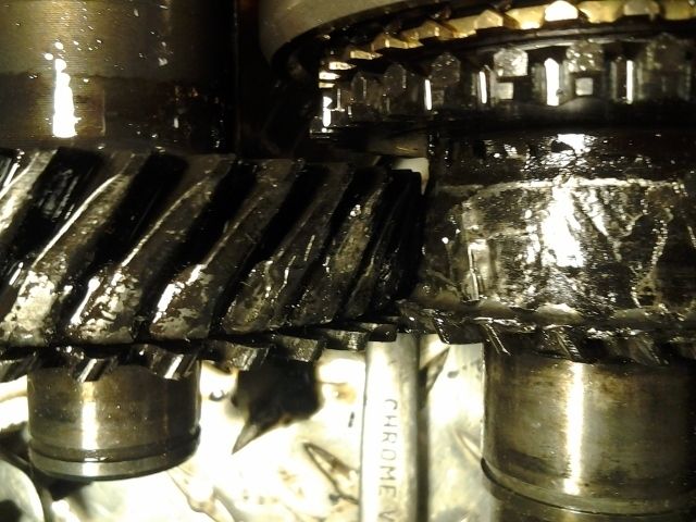

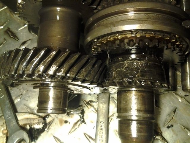

WELL.....i got the tranny back out and taken apart. im not doctor but i think this one is terminal.
I couldn't see the damage until i got the front casing off
