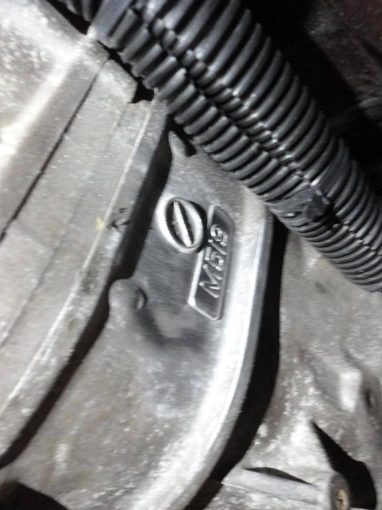

Ok here is a quick pic of my 87 b2200 5spd trans.Small pic yes but does have M519 stamped on the rhs back from slave clydr.Not sure if the b's I have checked have this or it was just for this yr,or mold.Thought I would share being I washed/waxed my ride and polished the whls today.

I searched here and elsewhere, and found some info on the M-519/M-520, which is helpful.
It looks like most all of the Mazda trannies were just about the same, other than the Turbo and B2600.

just looked on my 86 5-speed and has that M519 stamped on it. Only thing I've seen different from b2000 to b2200 is the gussets or bracket/braces between the engine an tranny. My 86 had one on the driver side and nothing on pass side and grabbed some from a b2200 in the junkyard but noticed they were different styles. But as far as I know the bellhousing and all are interchangable between 86-93 b2000 and b2200 models with manual tranny.

I picked up the tranny yesterday from a guy that had it on CL in Covington. $100. It's marked M519, but no other markings I could find. anywhere. There appears to have been a small, maybe 1.5" long sticker, on the top right of the bellhousing, but it was of course illegible at this point. Having dealt with a lot of old Chrysler stuff, I'm used to the VIN being stamped on the engine and tranny, so I find it odd that they didn't do the same here. I guess it just adds more cost.
