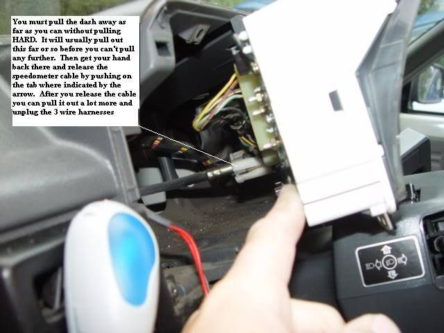

rg2200
Yup, done it before, you just have to remove the instrument cluster. Push the cable into the cab through the firewall as far as it will go (to give the cable some slack), then pull the instrument cluster out as far as you can, then there's just enough room to get your hand behind the instrument cluster and pinch the clips on each side of the speedo cable connection to release it from the back of the instrument panel. It's pretty easy from there.
axel breaker earl's avatar
axel breaker earl
Here is a pic to help you out a little.....
