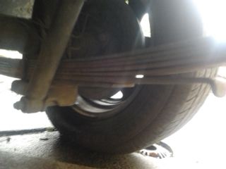

Hey just lookin to find out how many leafs are usually in dualcab 91 mine has 7.... A 4pack and 3 seperate ones can i remove the 3 seperate ones and put guide bolt baxk in n tighten u bolts
any help would be good thanks

pic? You "can" take out all but the main one that bolts in and the flat overload leaf. But a pic would be more helpful.

Yeah wil take a pic tomorrow and post it i thought there was only 4-5 leafs but my ute was used by concreters so maybe load leafs were put in

Hey just updating with the picture there is 7 leafs .i should be able to take out bottom 3

From the looks...you keep the very bottom leaf, the one in the middle and the mean leaf...rest can go

Hey jus an update i pulled out the leafs that "mazdaman82" mentioned..i made and put an inch block in. it dropped her a fair bit haha..cheers for the info guys
