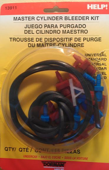

Okay got the kit in the mail, looks like so:
I like how it says HELP! on the package... heh.
Now if I can just get it to stop raining for a few hours tomorrow, I'm all set.
Yep, there's not much to the kit, but different threaded adapters in several metric and several SAE sizes, plus tubing, plus holders to maintain the tubes from those adapters in the brake fluid inside the clutch master's reservoir. There will be multiples so that it woill be applicable to brake master cylinders as well.
I can't remember, so take an 8mm and a 10mm box or combination wrench, a piece of tubing, and a jar under the truck with you when you finish the bench bleeding and attach the fluid line, that you don't have to make multiple trips down under. Use a vacuum cap on the clutch bleed screw when finished if you don't have a genuine rubber cap for it.
