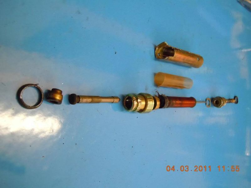

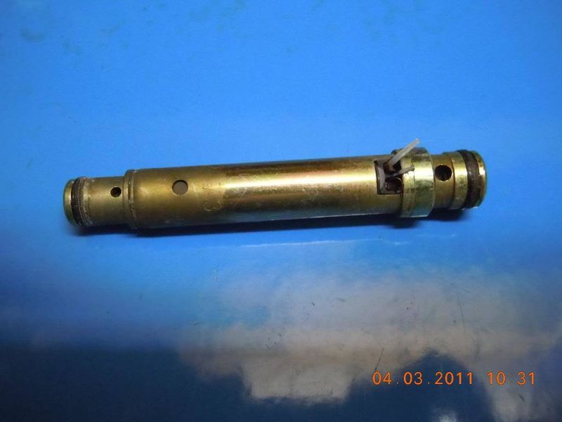

Here's what the mixture control solenoid looks like when you tear it apart.......don't do this to a good one, it won't be "good" anymore!
I grabbed this one from the JY because someone tried to remove the top of the carb and broke the wires and mounting flange out of it, so I figured it was the perfect one to tear apart!
It's basically an electromagnetic solenoid that moves a spring loaded plunger that opens a jet and lets the fuel flow through it..... if it gets dirty on the inside I'm sure it will hinder it's performance which could cause the computer to enter limp mode.
