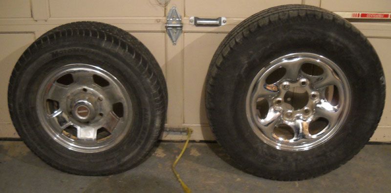

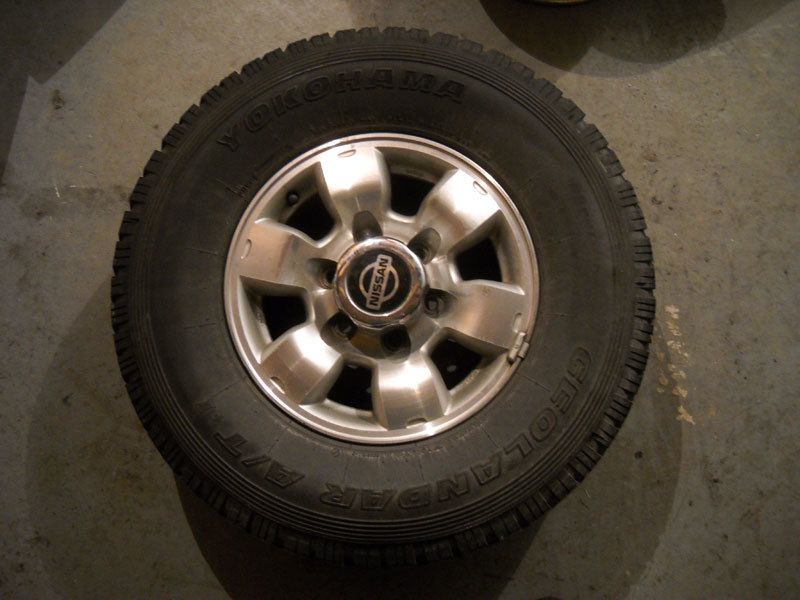

That's great, thanks! I bought a few sets of used rims, all 15" 1990s Nissan Pathfinder rims. One is a slotted design with a chrome finish, the other is a 6 spoke aluminum. Since they're for a Pathfinder, those rims are intended for a 4x4. I haven't actually tried bolting one up yet, but I've heard from a couple of people that they should fit.
I stayed away from the the Dodge Dakota rims as I wasn't totally sure if the bolt pattern spacing was the same. In any case, it seems that there was a lot of 15" Nissan rims available, so that's what I ended up with. I didn't want to go any bigger because I want to use a tall, high profile meaty tire for my PreRunner look. If I went too big on the rim diameter, I would have needed to use low profile tires.
As for tire size, I have a set of 235/75R15 that I want want to use, but it looks like I need to do the lift first or they won't fit. The width might be OK, but those tires are too tall for a stock 2WD height.
