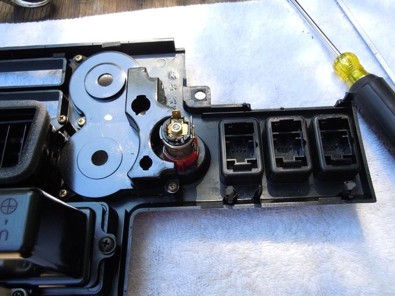

He He! Here's a little photographic montage of what you missed Cusser!

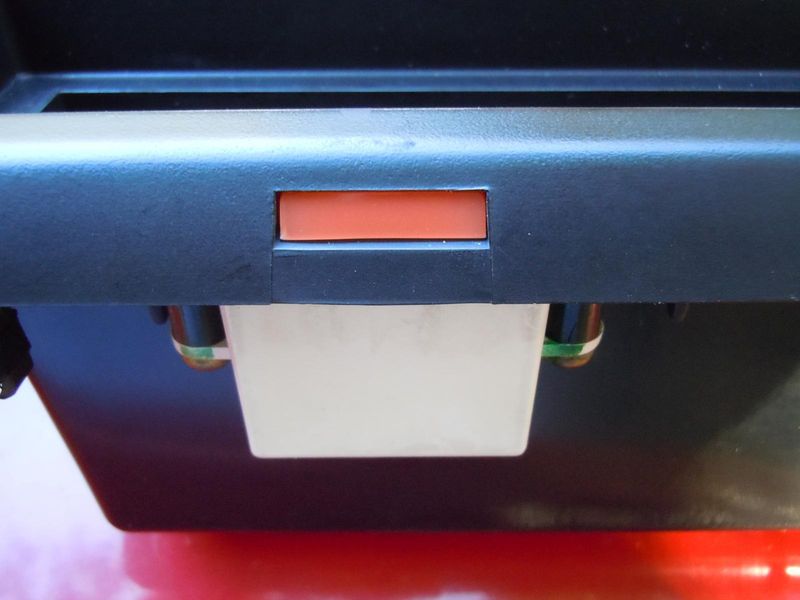

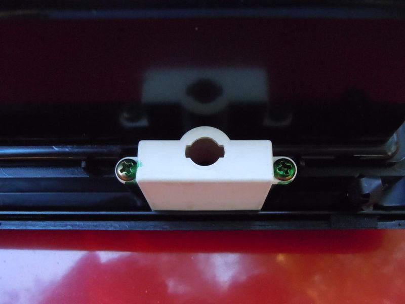

Here's the ashtray light.....
But most of the trucks come with it like this......
NO BULB!!

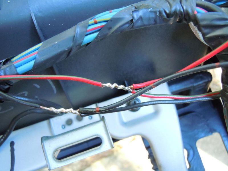

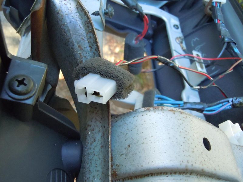

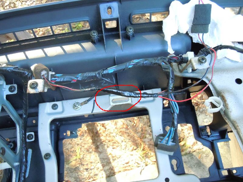

But as SCL said, you can grab the tiny bulb pigtail from the A/C & Heat slide controls and solder it into the same circuit and then use it for the ashtray light. Like this!

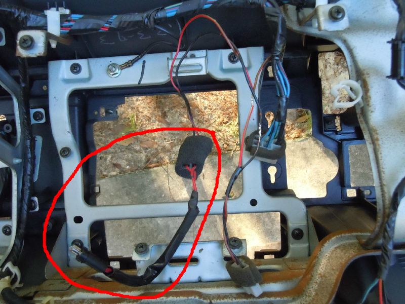

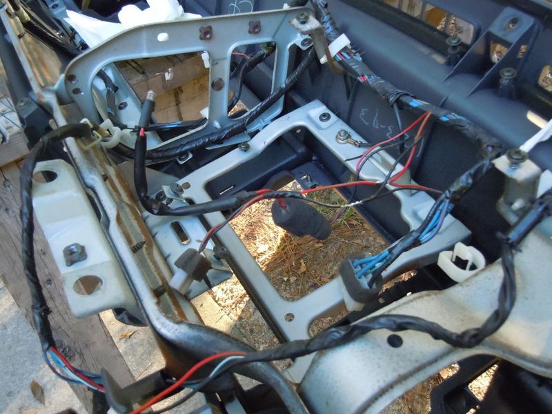

I got the whole harness for it which included the connector also, this way I can remove it if I wanted to......doubt that I ever will, but.....
And all taped up.....now I just have to plug the small bulb harness into the connector and the truck will have the faint glow of the ashtray........for mood lighting I guess, since I don't smoke!
This is what plugs into it.....
You can also add another pigtail like this to light up the orange ring around the cig. lighter as well. See the small hole here......most trucks won't have a bulb for that either.
