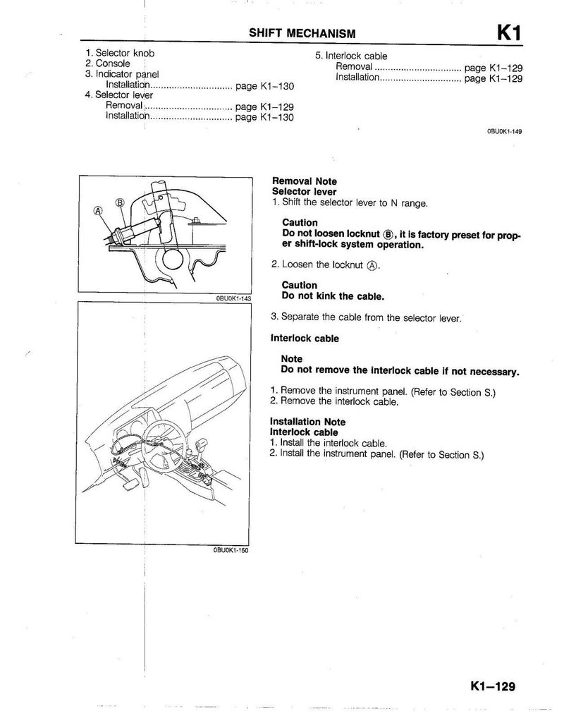

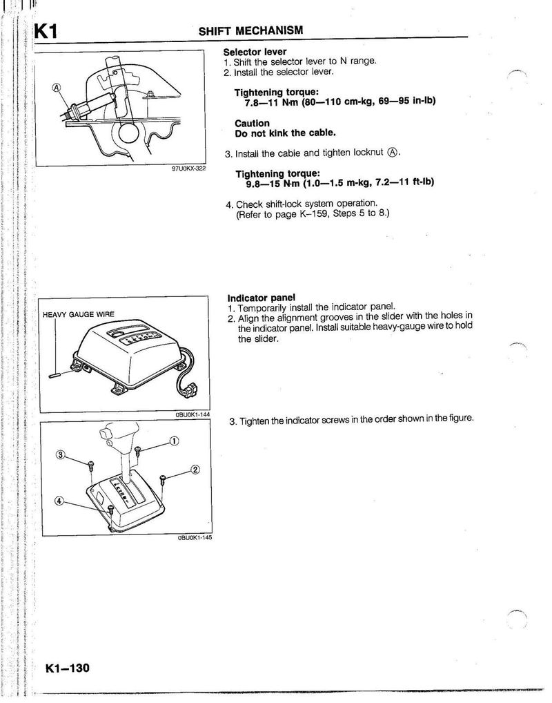

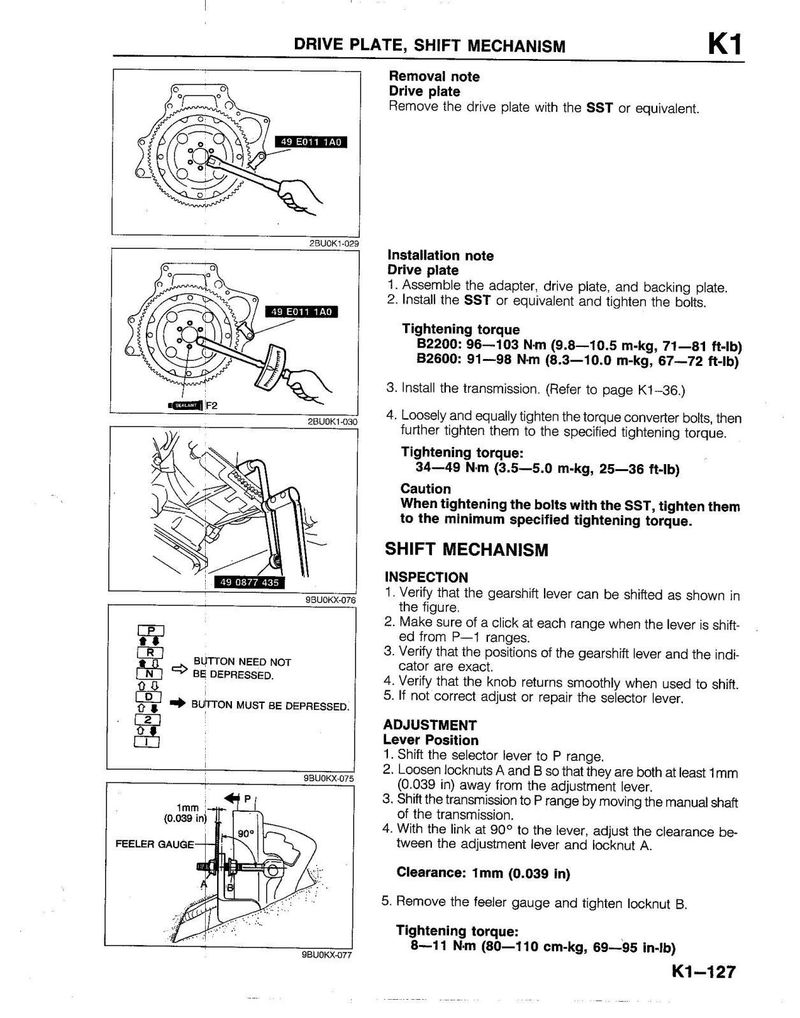

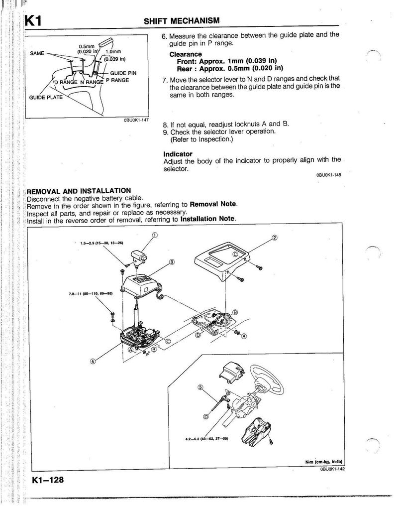

I think you need to do a cable adjustment on the shifter linkage Dan.
I need to look at the factory service manual and see if there is a procedure for it.........or am I thinking of my son's Honda Civic here.......I'll look and see!
Here you go Dan.......
I think your shift linkage may need adjusting......if you need me to send these to you, PM me your e-mail addy and I'll get them to you.

Thanks Earl!! That will help a lot. I got a copy, electronic, from someone a while ago but it is not complete so I could not find what I needed. I'll have a look at it this weekend. Once again you are a great help!! I'll send you a PM, THANKS!

Well as it turns out changing the transmission mount must have "caught" the loose manual shaft because all four bushings were gone, not a single trace of them. I replaced all four bushings and the tranny shifts beautifully and stays in park again. Looks like I was playing with fire and didn't know it. Mainly because I never use the parking brake on an automatic, I always use it on a manual. Details will be on my project post.
