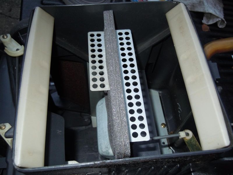

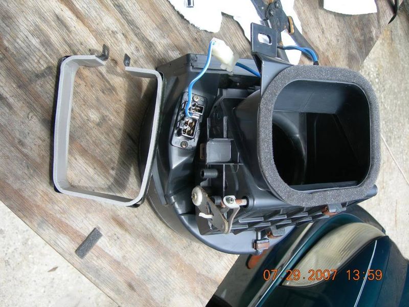

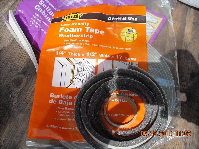

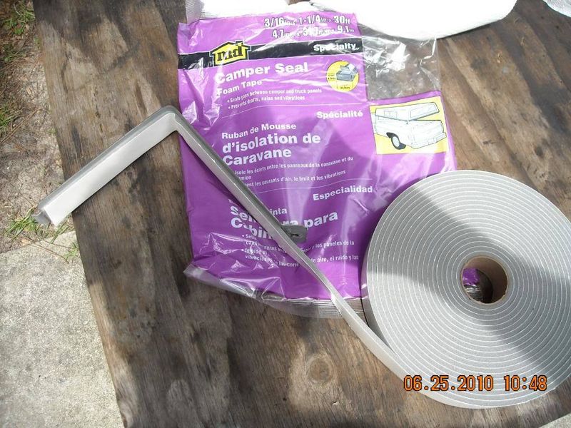

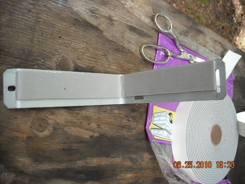

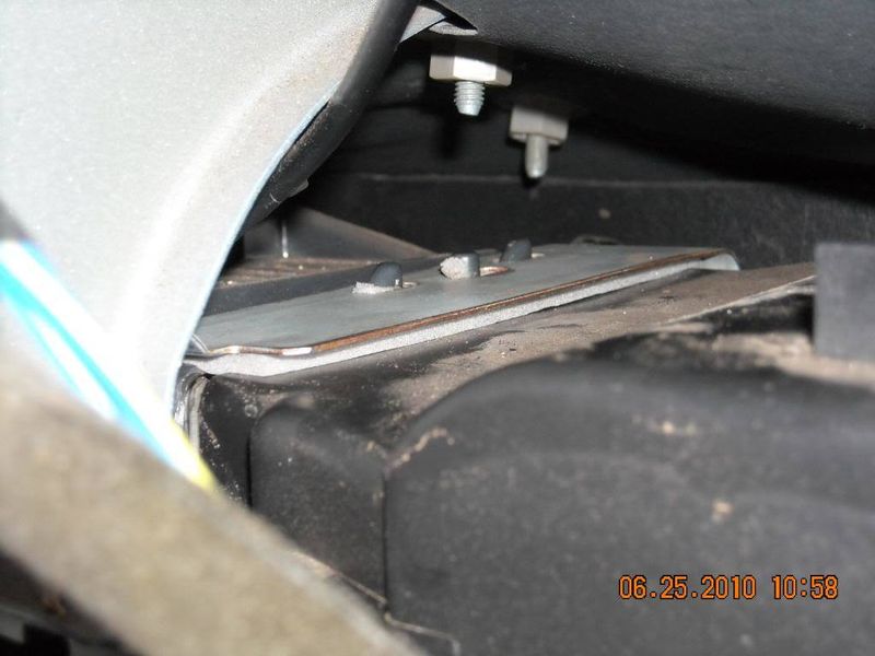

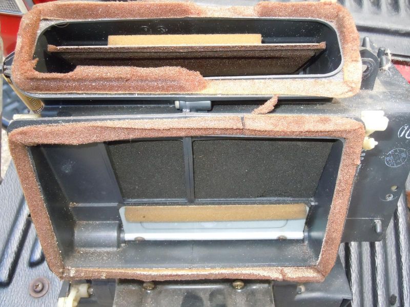

Here's what I used NewbieT......
For the 2 brackets that seal the heater core housing to the evaporator housing, and the wrap around bracket that seals the fan housing to the evaporator housing.

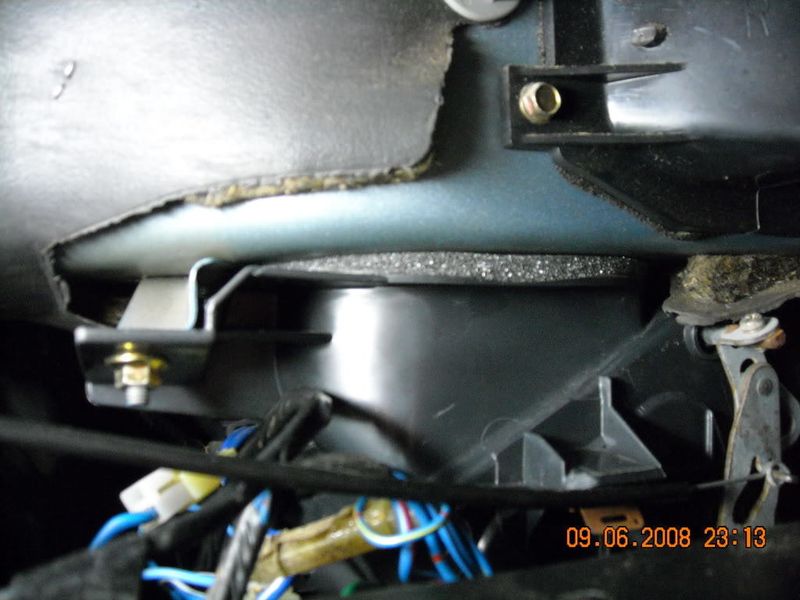

On the top of the blower housing where it seals against the underside of the cowl, I used this foam tape......

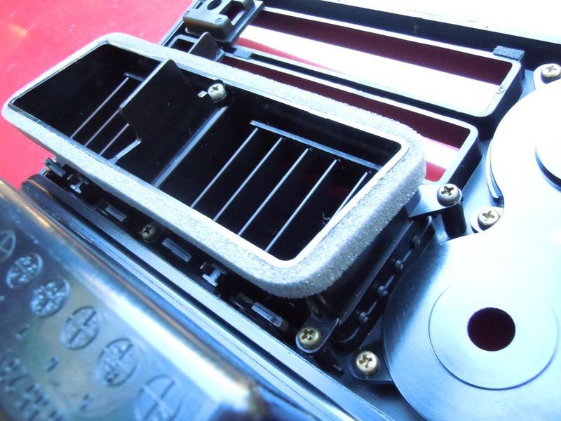

It's an "Open Cell" foam weatherstripping tape and it will come in different widths (up to 3/4" I believe) as well as different thicknesses. I used this on the flap door inside the heater core housing also, and around some of my plastic vent louvers as the factory had......but the factory stuff was shot. If there was any still there in place, when you touched it the stuff would crumble.

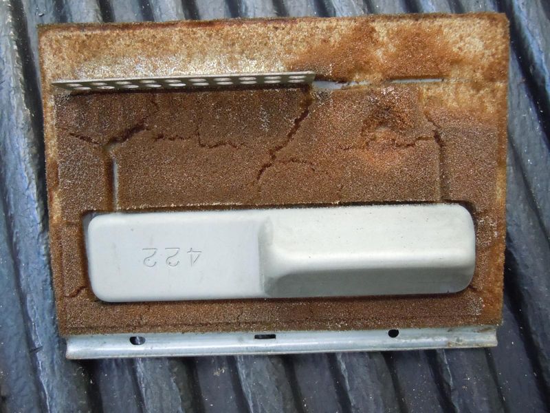

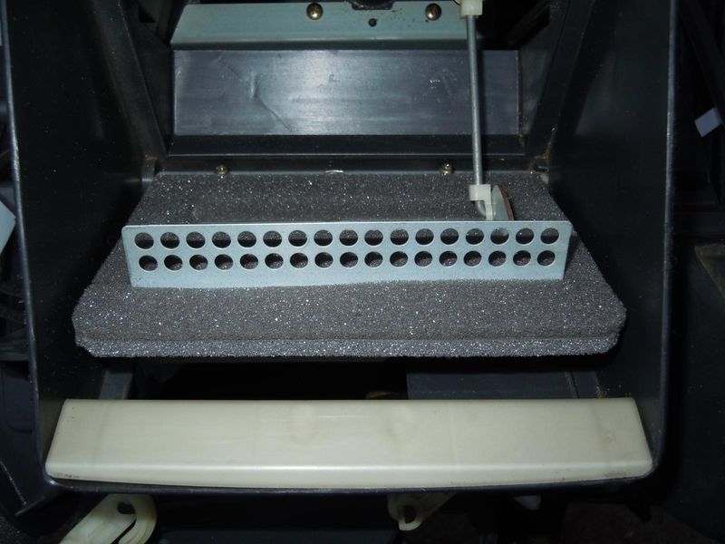

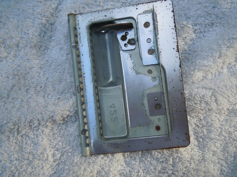

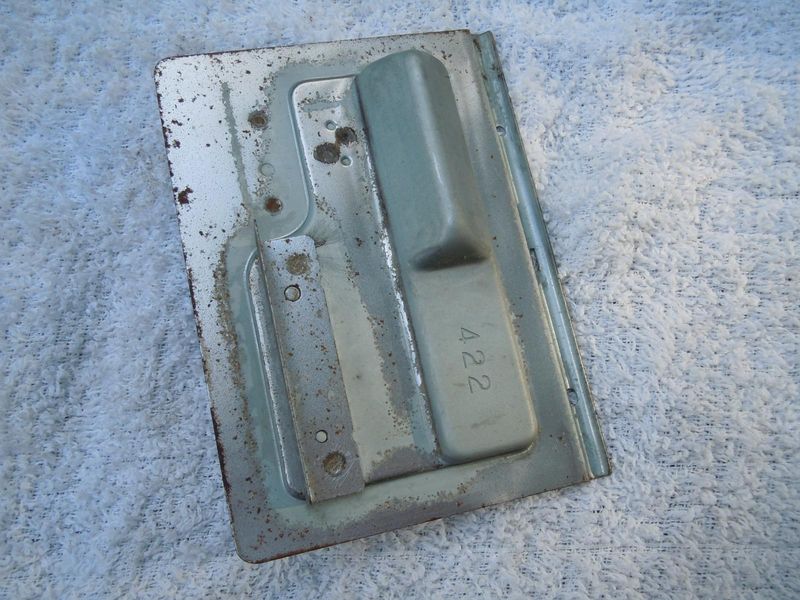

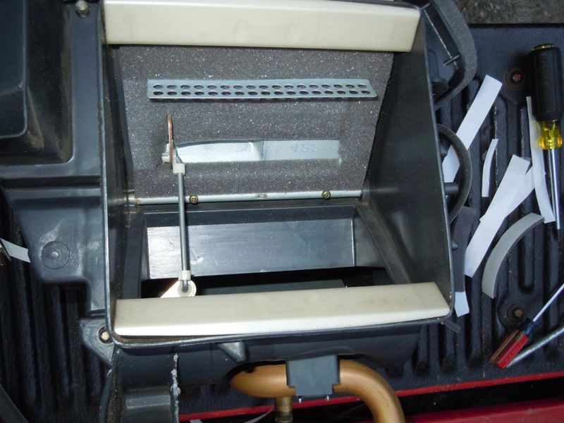

Here's that flap door inside the heater core housing that I put new "Open Cell" foam tape on....
Cleaned the old junk off.

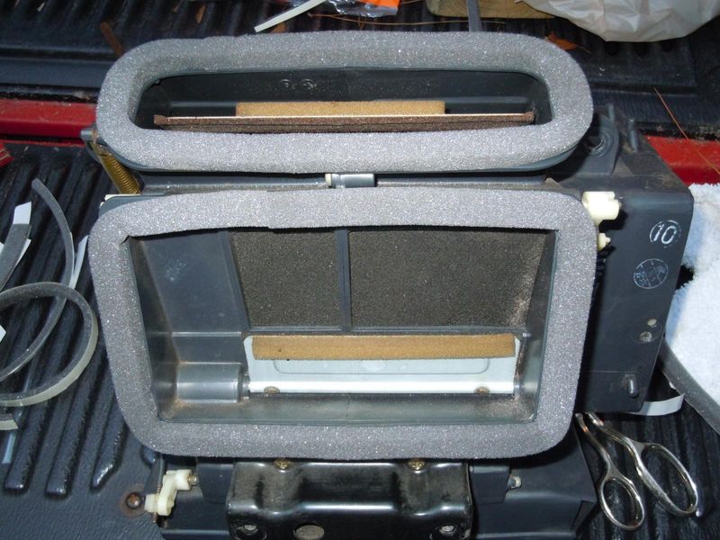

New foam.

I was hoping you would answer this one axel . Yea the stuff I used was a little to thick so it made opening and closing a little difficult but I cut it down a little and good to go. Is that 3/4 the size that goes around the HVAC vents on the sides?
