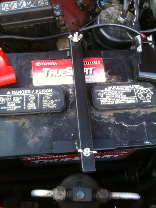

hi, my truck was missing the battery tie down so i was wondering if anyone had a pic of theirs so i can use it to build one.

i figured thats what it was but i'd like to see where they attach. i couldn't really find any slots in the battery tray for j-bolts.

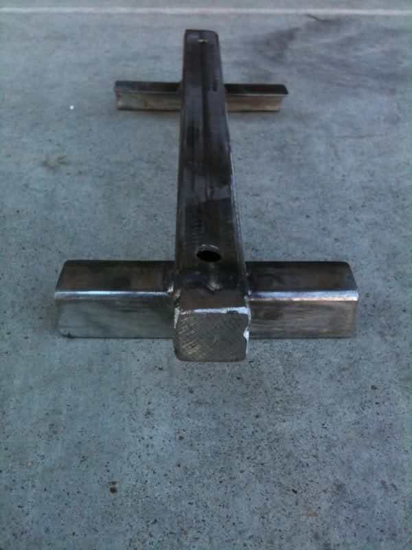

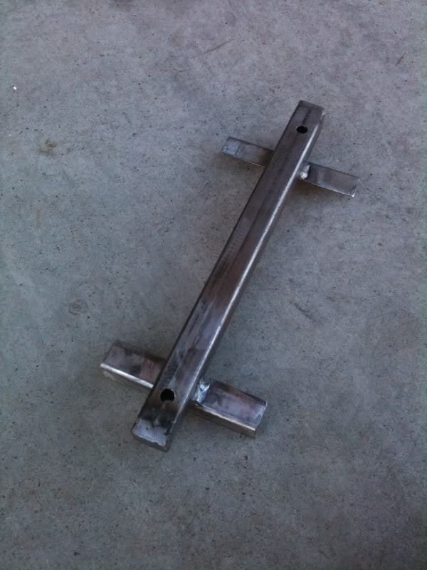

ok so i bought one from kragen but it was such a pos i decided to make one. while i was at it i replaced my starter wire, ground wires and battery.

Mine also looks like this, used the top mount as purchased at discount parts store, and used two long J-bolts, one of which I hacksawed shorter. I smear a little wheel bearing grease on the threads and wingnuts so they don't rust or corrode, same with the battery terminal nuts/bolts.

i junked the tie down that came with the kit and just used the j-bolts in the pic. i don't like using grease because its messy, if i get corrosion i just clean it and use corrosion preventative spray.
