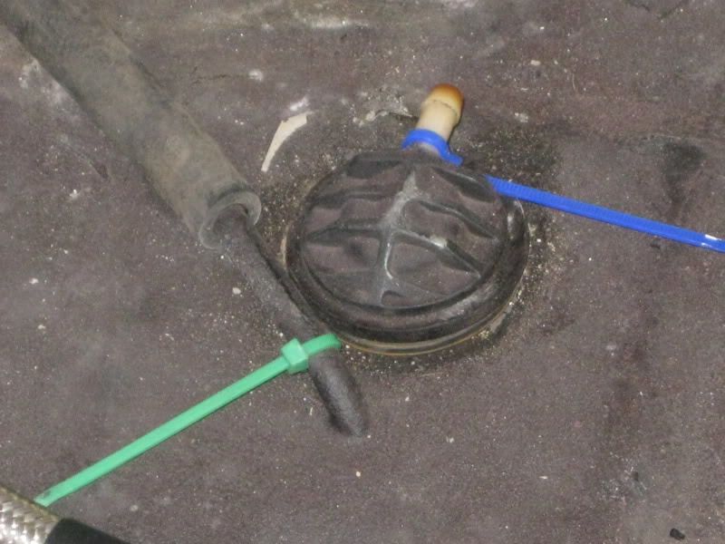

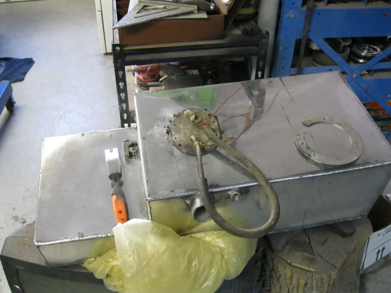

this is a 1989 2wd standard 2.2 motor and i am putting a fuel cell in it and need to know what these all do for setting it up the right way
: what do these do?? im assuming the one i have the blue ziptied is some sort of vent valve roll over valve. and the green is a ?? return??
and the yellow tagged one is primary feed and the one i have the red tie on??

you are correct

so the one on the factory sending unit, that i have the red zip tie on hats that for? and what exactly can i get away with eliminating for the cell install. i gotta use the vent for the fill tube for a return port already and i dont want to put anymore holes in tank. so i am going to run the 2 back to the sending unit and that one next to vent as my return, sound righ or can i dump that line to and just run the ones on the sending unit.?

well i conseeded my loss here and sought out someone who is helping me out with this: the dude im getting my bed from, haha lovin this dude for sure,so as i referance a color for each "line" the color denotes the color ziptie on the factory parts, withthat said, the red is return, and the yello is primary feed, blue is a rollover vent, and green is also a vent tube , i am T'ing off those 2 vent lines, and in my cell i am drilling a hole, threading it, and screwing in a barbed fitting as to add a small filter, like for a valve cover or whatever, those little tiny air filters, anfd that acts as the vent for the tank. as for youre fuel pump, if its a powered one and its regulated you should be able to put it and a new filter in line of the feed.
