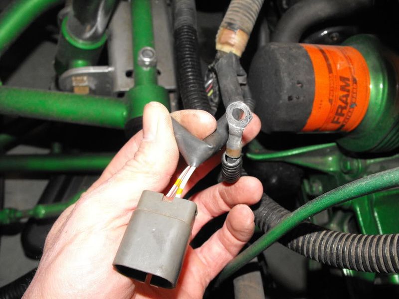

i have a 100 amp gm 1 wire altenator i have it installed but im not sure what to do with the plug from the stock alt. can i just leave it? I think the gm alt has everything internally? will the battery light come on and stay on in the dash? i kno a few people have them what do you guys do with it?
the plug from old altenator.

on the altenator plug, one wire will be ignition turn on and the other with be for the dummy light on the dash, i pretty sure you dont have to hook them up to anything, it should work just fine hooking up the main power to it

I never hooked up the plug and didnt have any problem. Just ran a big power wire from the alt to the bat.
