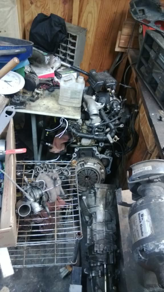

Well Pick N pull had a half price weekend, and I knew that the sportage swap was viable, just didn't know how viable. SO I went and robbed one out of an 01. Took the engine, tranny, ecu and wiring harness, but I didn't get the engine bay fuse box, I wish I had, would have saved me a lot of work.
Not having any time for it, I deposited it quietly into the corner of the garage where it awaited it's install.

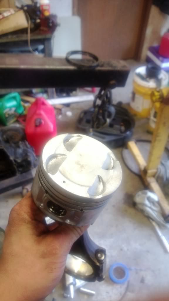

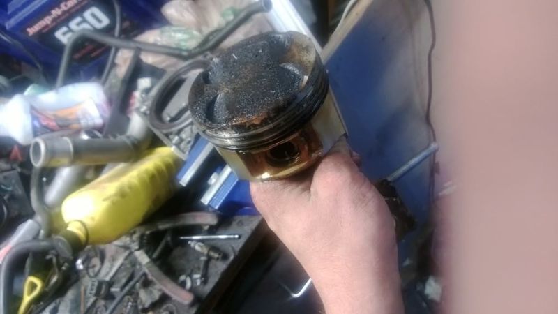

Since I couldn't return it or exchange, and I hadn't bought the extended warranty ... I tore it apart and got ready to rebuild.

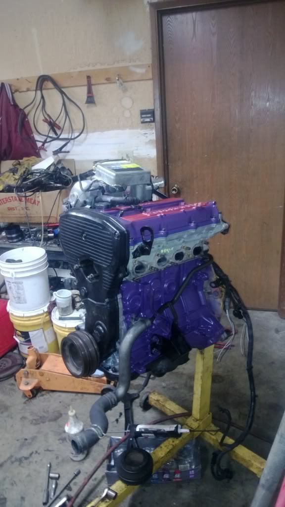

I probably could have just cleaned the rings grooves, I think it was just carbon locked, and the rest of the motor looked dandy. Aside from some gunk on the intake valves and a little less than perfect valve sealing, but then I dropped a piston and broke it, so I had to order a new one ... and then it turned into a whole rebuild. I bought all the parts and got to work. I didn't hone the cylinders, it was an experiment.
All the seals and gaskets and whatnot are new, the only things I didn't replace that you normally would are the bearings. they looked brand new with 135K on them. I decided to keep the Kia's factory bearing clearance settings and not mess with what was already working.
Had to do a bit of cleaning. Each piston took me quite some time with my wire wheel on my bench grinder, a broken piston ring, and a gallon of berrymans chem dip.
Before:
After :

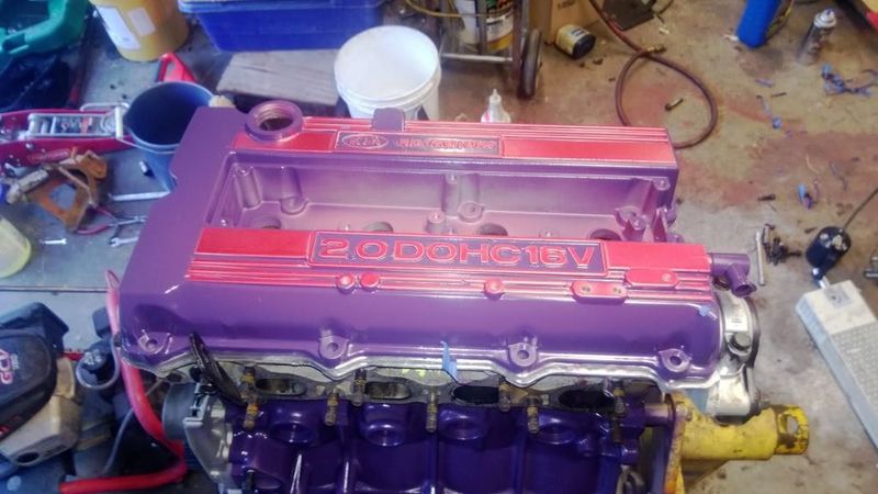

I painted the block and assembled it, I didn't take many pictures so sorry.
I did a terrible job of masking and painting my valve cover.

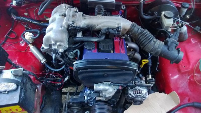

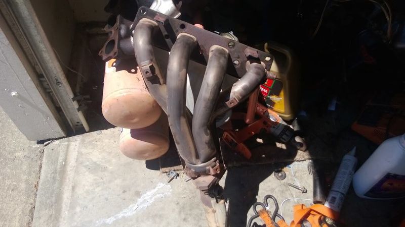

Went to the junkyard and took the header off of a 97 sportage, as well as the engine bay fuse block and a couple other miscellaneous bits.
Followed SilentDawns directions on drilling the transmission bellhousing for the crank sensor. I was going to use the Kia 5 speed but it has a few differences that I didn't want to deal with. Mainly it's a bit shorter than the mazda unit which would require driveshaft lengthening, and the shifter is about 3 inches rearward of the mazdas, which would be an easy fix but I didn't want the hassle. The crossmember mount is rearward too far too but when you flip it around and bolt it on backwards its within about 1/2 inch of the mazda piece so thats an easy enough fix too. But I dont have a welder and I was trying to just get it done, so I skipped on that and will maybe think about it later.
Then I bolted it in.
I didn't want to cut my hood so I got an Idle air control valve for a tiburon or something like that off amazon for like 23 bucks shipped. It works perfectly and gives the clearance you need.
I followed SilentDawns writeup for the majority of it. But I deviated and did my own thing in more than just a couple areas, I will explain those later.

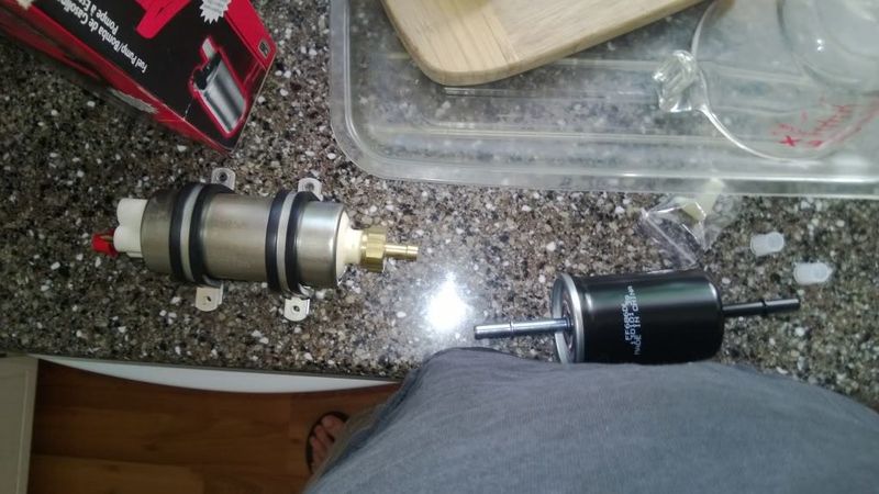

I got an airtex pump and a fuel filter from autozone, I was going to mount it in the rear of the truck but was concerned about ease of access to it and ease of theft. Plus FI hose is expensive. So I just put it in the engine bay.
I ran the sportage accessories Because I didn't want to change to the mazdas, I liked the multi rib alternator belt and the higher amperage (or so I think its higher amperage?) alternator. Plus it looked cleaner.
I still need to get the power steering hooked up, and I want to replace my heater core before I hook it up because I mangled the pipes for it a bit on accident when I dropped the motor in.

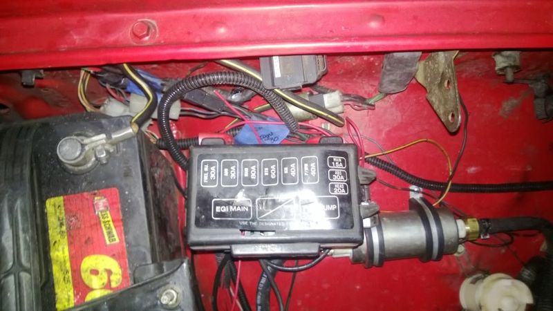

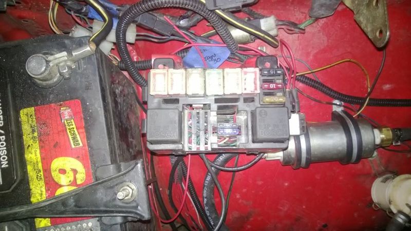

3. (He mentions this) I used the Kia fuse block and modified it to get rid of the Mazdas original fuse block. I added only 2 fuses, one 15A for BOTH O2 sensor heaters, and one 15A for the fuel pump. Adding fuses is easy. Modifying the block to delete the mazda block is a little more work than just powering the Kia block separate, but not too hard if you are competent in soldering and wiring schematics. I've always had a knack for that sort of thing as well as mechanical stuff, your mileage may vary, but you CAN do it. Just be patient and PLEASE solder and heat shrink your connections as much as possible. Nothing worse than seeing a good job ruined by butt connectors. They work okay. Just okay. Better when you get the good ones, but at the price you will pay for the good ones you will be ahead of the game getting a soldering gun and some solder and cheap heat shrink off amazon.
Heres my fuse block mounted to the modified fuse box bracket.
A shot of inside, I changed a lot of the fuses inside to match their appropriate amperage ratings for the existing wiring. The two blue 15A fuses right next to each other are the ones I added for the fuel pump and O2 sensors.
If you have the newer style fuse block you are ahead of the game as there's lots more fuses in it and you will already have fuses for the 02 sensor heaters and I believe the fuel pump and whatnot in the box ready to be spliced into.

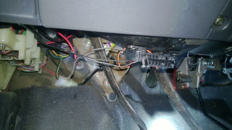

6. If you choose to add the OBDII port You'll be tying into a brown wire from Pin 83 of the ECU and putting it on Pin 7 of the OBDII port. The Kia uses ISO9141 so if you look up a generic OBDII pinout you'll want the ISO9141 K-Line pin (which is 7) I used one from a GM car cause they are usually really easy to access and always have screw in mounting brackets. The two ground pins 4,5 I just ran to a bolt under the dash and pin 16 I tied into the brake light switch power side. I screwed the port to the head duct just below the steering wheel.

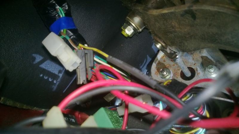

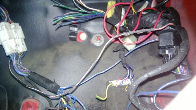

7. Your tach wire is under the dash in the harness that goes to the engine bay behind the gage cluster. The wire color is yellow with a bluestripe and brown dots. You need to wire this into either pin 25 or 52 of the Kia ecu, yellow with a white stripe or yellow with a blue stripe, Either will work but not both. Your tach will only read half RPM because you are only getting half of the engines ignition pulses. I'm working on a way around this. I know SilentDawn said he has been modifying the Mazda tach with Kia tach parts. I'll try to figure out a simpler way but he may have found the best way.
The tach wire tied in with the tach wire.

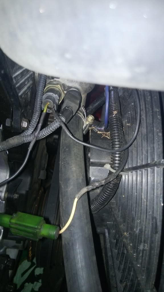

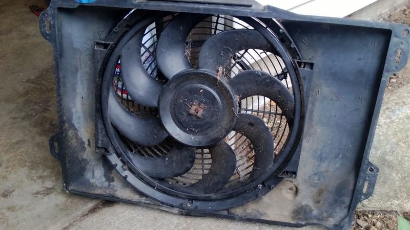

8. I used a flex a lite fan I got from my buddy for free a while ago. It fit inside the mazda factory shroud (I didn't have any mounting hardware) and I just secured it with a coulple sheetrock screws to the shroud, and that bolts to the radiator factory style, works fantastically.
To control the fan I used a Honda fan switch and installed it in the Tstat flange in the spot that looks like its supposed to almost have something in it. You need to drill this out so coolant can flow to it. The honda switch is an M18x1.5 thread pitch. This is the same as an o2 sensor or an 18MM spark plug. Tap for it is easy to find. I used a 5/8 drill bit and drilled into the housing until I was deep enough that my hole joined in with the coolant flow. then I had to grind the hole I made a little bigger as it was too small for the tap. tapped the hole and threaded in the sensor. Looks like it belongs and it works perfectly.
This is run to a relay I wired in next to the engine bay fuse box (I can provide instructions/diagram for this if necessary) and the power for that relay is run off the Power window fuse from the Kia box. Please note, THIS ALLOWS THE FAN TO RUN AT ANY TIME THE BATTERY IS CONNECTED! After I shut the truck off when its hot, occasionally the fan will come on from the residual heat in the head transferring to the coolant. It runs for about 30 seconds until its cooled the coolant down enough and then it doesn't come back on again.
If you don't want it to be able to run unless the key is on, then you can pull power to the switching pin of the relay from the ignition coil wire.

I ran into an issue with the fuel pump. It quit working. I removed the carbed fuel filter that I was using as a pre filter and got the pump working again. My presumption is that the carbed unit doesn't flow enough and plugged up, not allowing the pump to pressurize. So don't use the carbed filter as a pre filter unit, if you have a strainer in the tank, good for you. I don't though, so I need to find a strainer or an inline strainer (may take one off my wrecked Scirocco now that I think about it) then you can go to it with that.

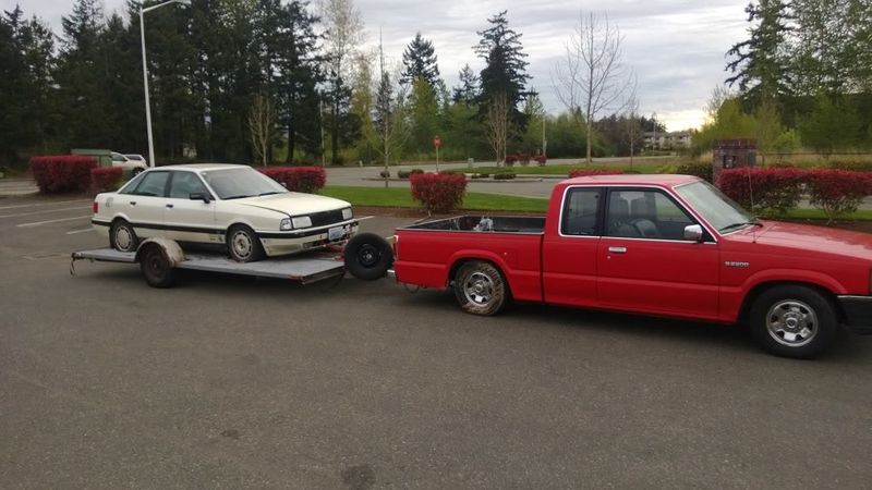

Truck tows a single axle car trailer with sciroccos on it just fine. Also 3/4 yard of beauty bark like it's not there.
