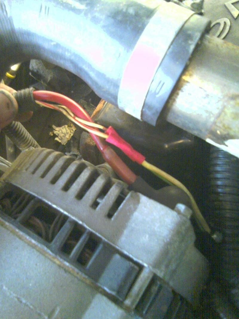

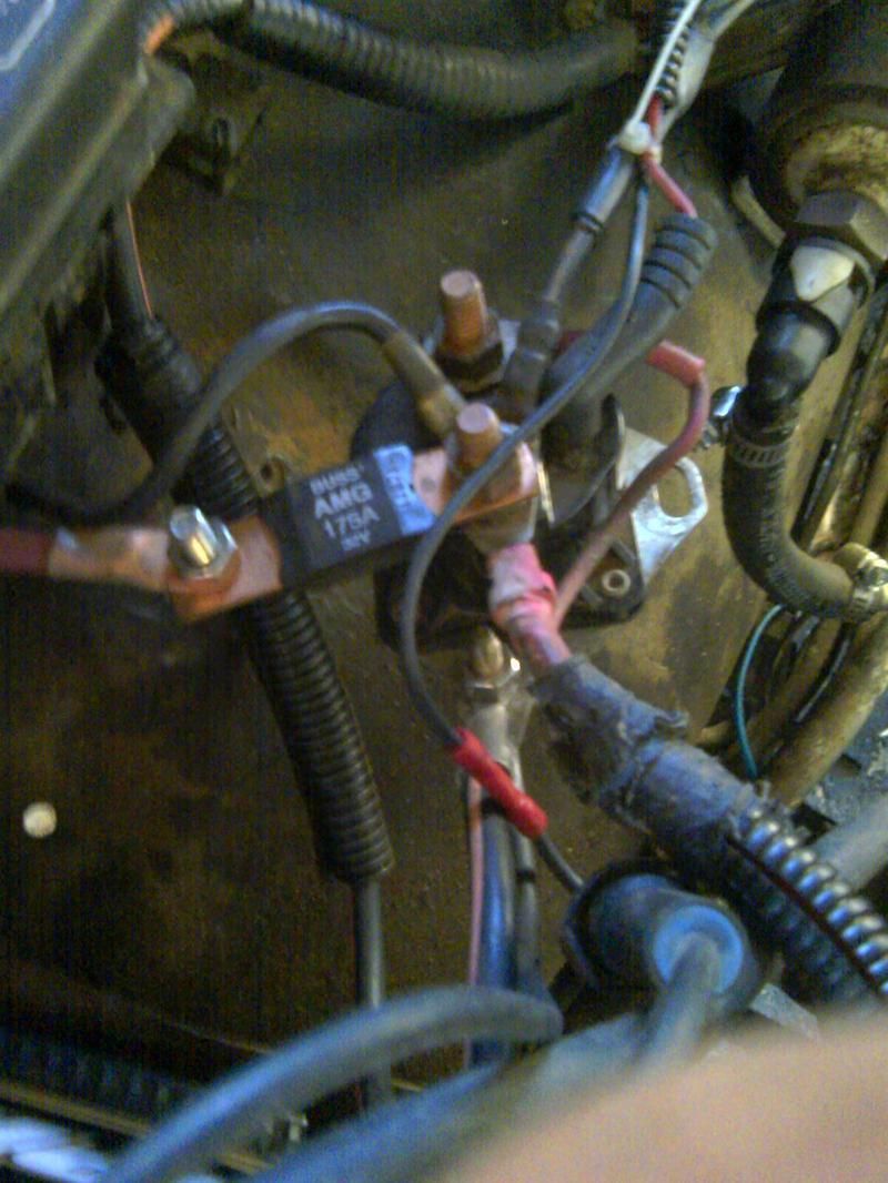

heres the 3g that i installed.
the black 10gauge wire the is coming off the stud on the solenoid where the 175 amp fuse is is the power supply going to the mazda fuse block under the hood. the red 10gauge is coming from the ALT. the spot where the fuse is on the solenoid has a hot coming from the battery. Hope this helps
