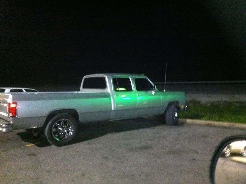

Well, it's warm again and time to work. My brother got a full time job so he can buy parts now without saving up for 6 months at a time. lol. Parts are being ordered so we can hopefully by 2015 have it on the road. I've been busy working on a gas saver for the wife. 96 Acura Integra with a b18 and automatic, so far I've replaced a balljoint, starter, alternator, drivers CV shaft, and now trying to figure out a idle issue it has. At start up it runs almost 2000 rpm's, then after a minute it drops between 1500 and 2000 and jumps back and forth like your reving it up. Slowly drops down to like 1000 after a while. Anybody know much about these cars? And I sold my fullsize 4wd and picked up a 93 s10 with a 305 and a 5 speed to play around with so my time has been spent between the two.
rickypopham

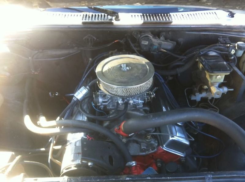

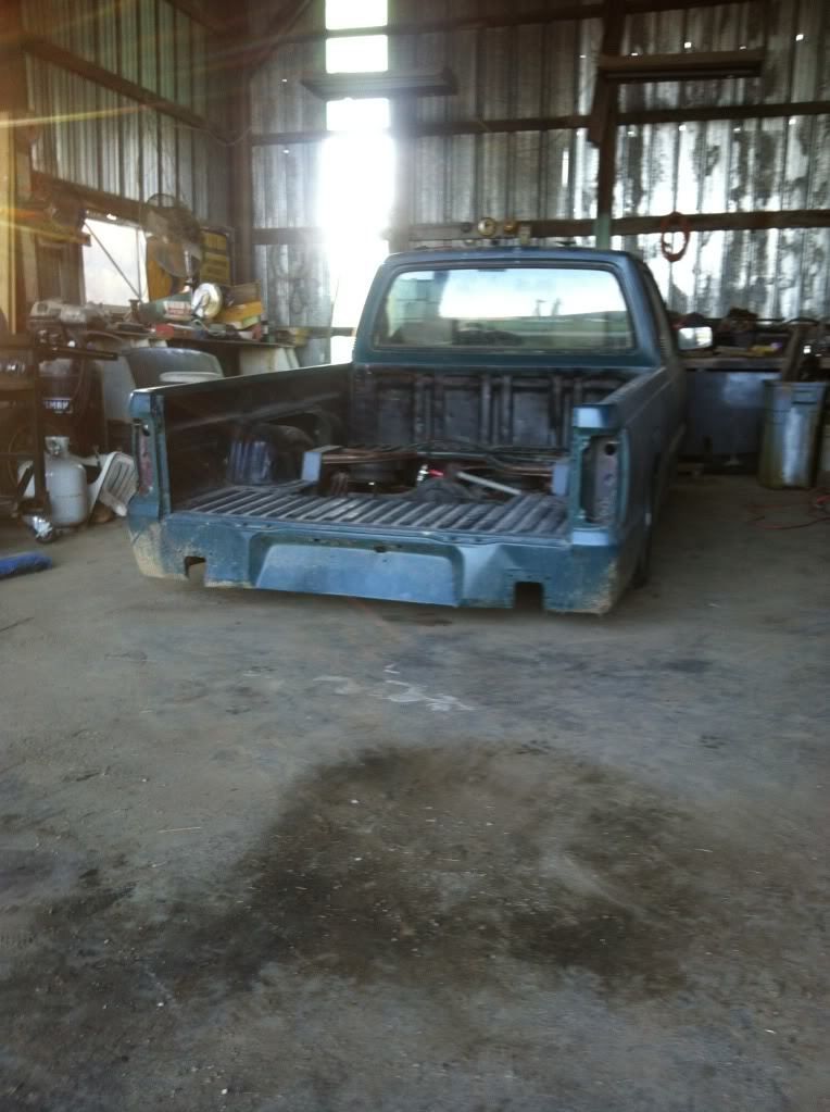

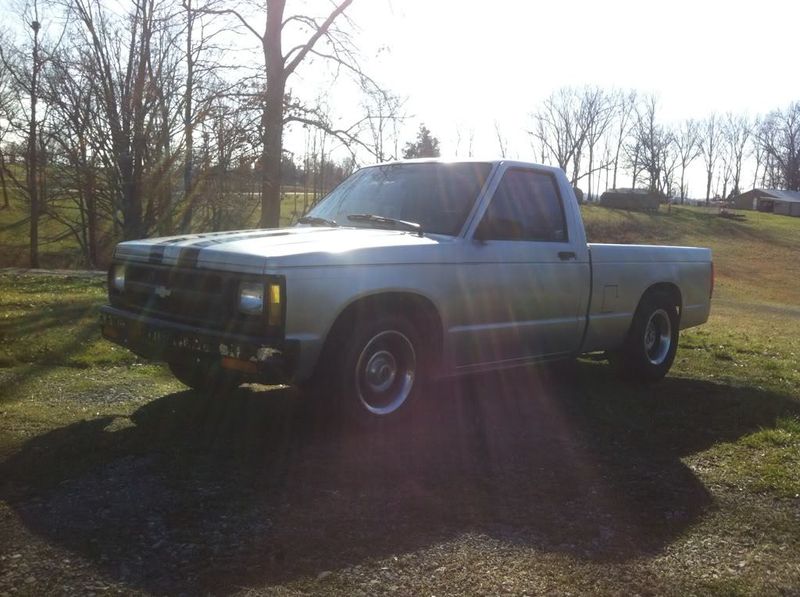

And pictures of my s10
