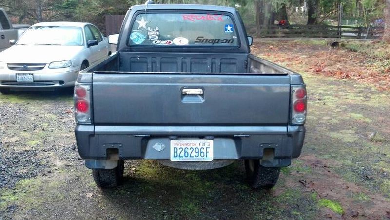

Well here is a pic of the lights lol. I wont get my header for a while yet lol.

Thats bout the only real update i have as of now. But the lights look so much better than stock. That and i broke one a while ago didnt have time to replace it till a few weeks ago.

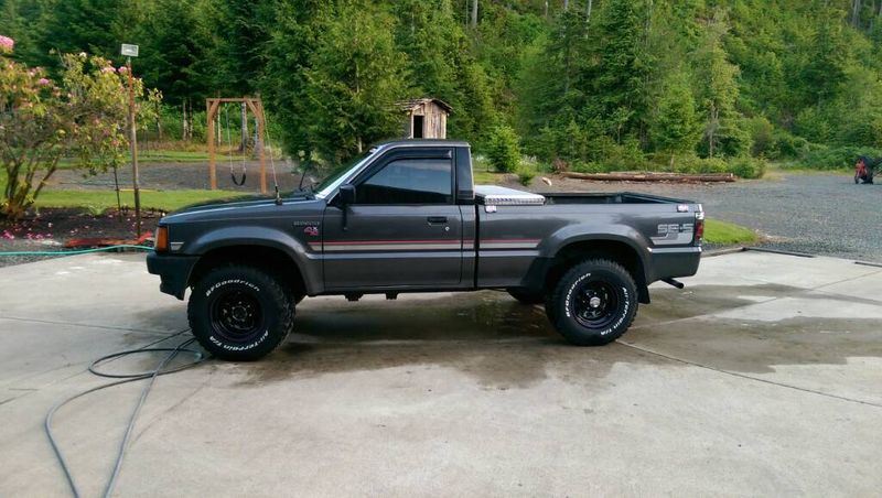

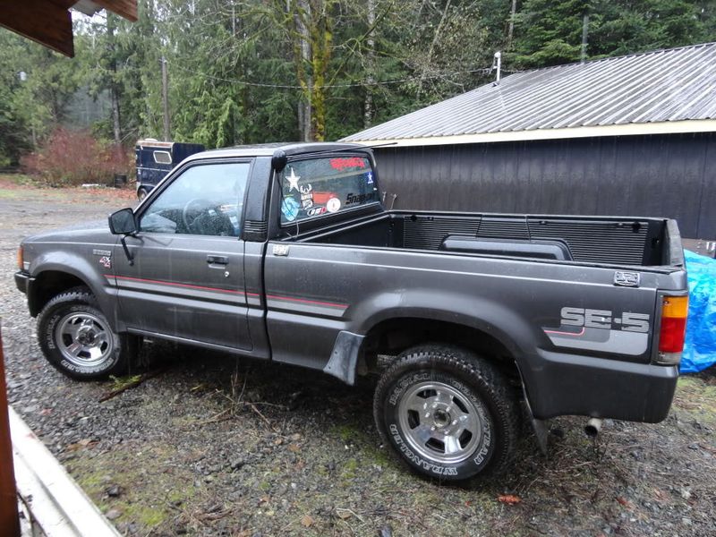

Ok I know it has been a really long time since I have updated this, but I now have cranked the torsion bars a lil bit to level it out, I have also put brand new 31x10.5r15 bfg all terrain tires on the truck and brand new rims. Just gotta fix a radiator problem and a few miscellaneous things and she is good for now. I have a picture of the tires and rims I think on my phone.
This is what she looks like right now.
