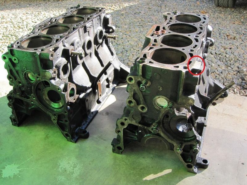

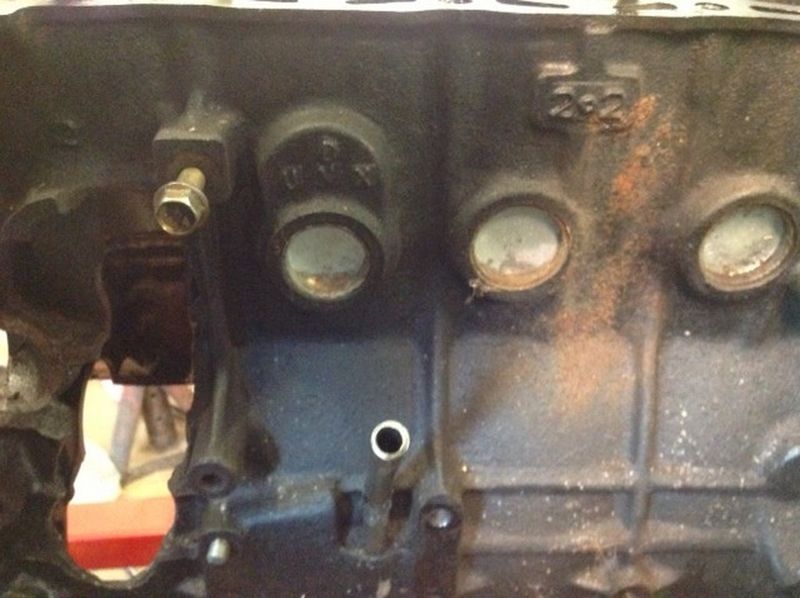

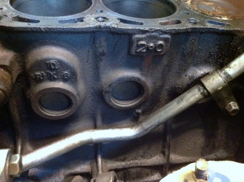

There is a flat spot facing up that will list the engine code. It usually has to be cleaned off to read it. I have it circled red in the pic. Also the exhaust side of the block will have 2.2 or 2.0 stamped see pics.
