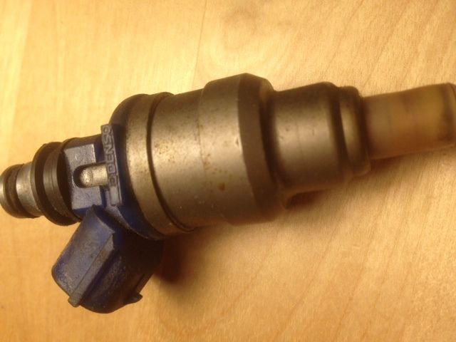

What's the part number on the side of them? I'm assuming they are Denso's?
If they are Denso injectors like in most other Mazdas there should be a number on the side that reads 195500-XXXX. The last 4 digits are the ones I need.

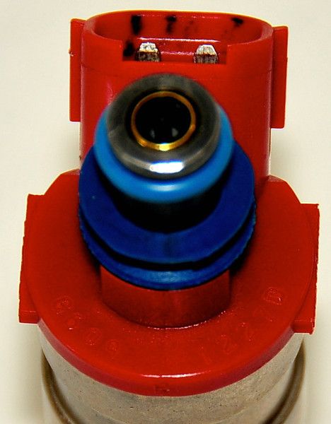

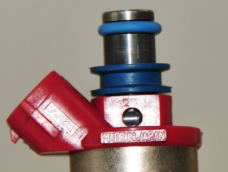

scotch

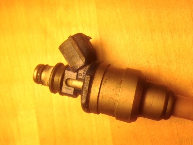

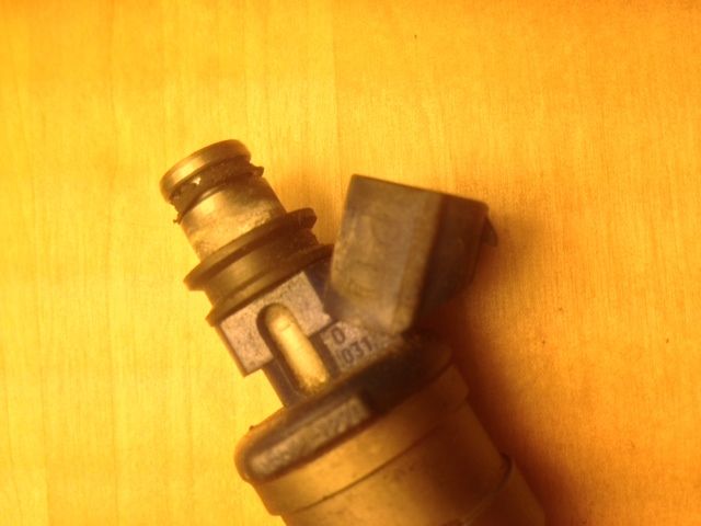

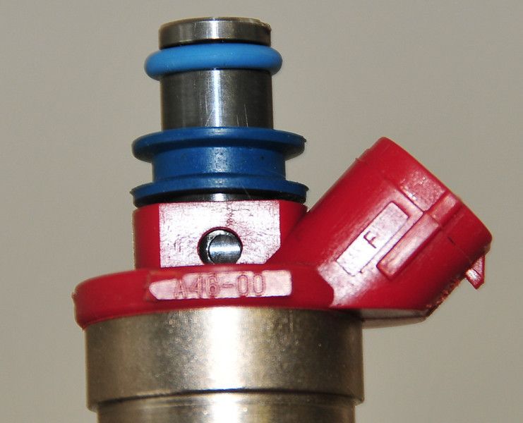

They are Jecs....A46-00
And on the top... looks to be a Mazda number... at least the G609 is the Mazda p/n for these injectors (90-93). G60913250

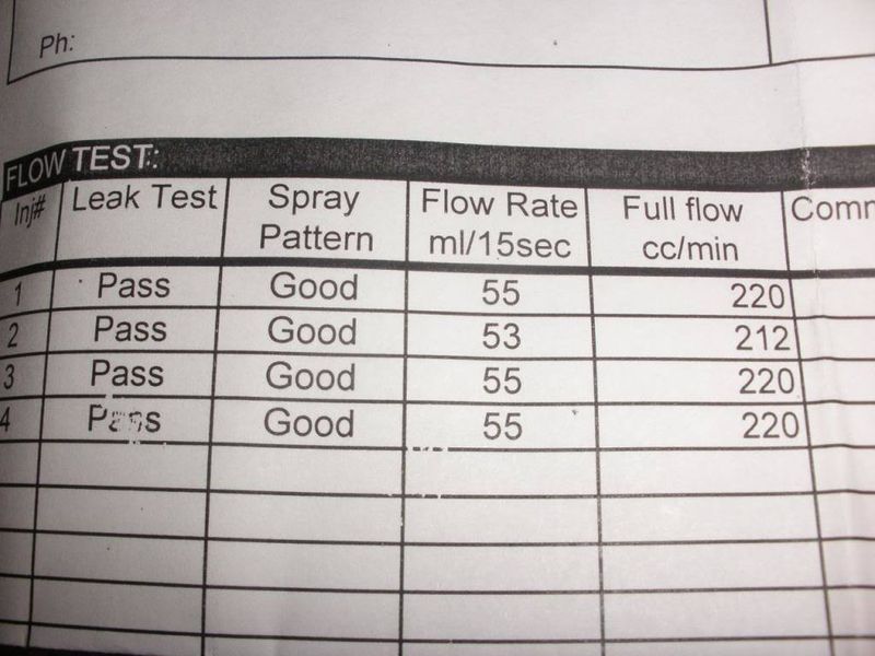

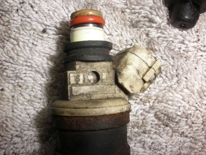

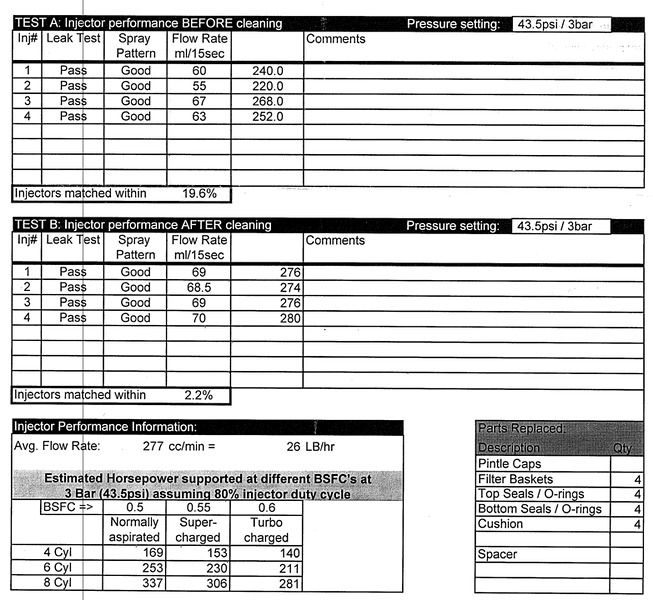

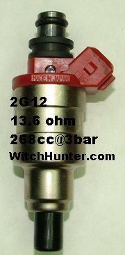

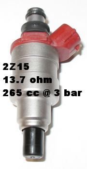

I usually only deal with Bosch, Denso, Ford (Bosch) and Nikki injectors so I'm not very familiar with JECS. This is about as close as I can find on that particular injector.
And I found one page citing 275cc/min which would be in line with the above.
The injector in the first pic has a Bosch EV1 style connector and the injector in the second pic has the Denso style round connector like the JECS you posted up.
All those come in at around 25-26lb/hr and the numbers seem right for a 2.6 because a Mazda 1.8 BP engine uses a 254cc/min-24lb/hr Denso injector and a Miata 1.6 B6ZE uses a 212cc/min-20lb/hr Denso injector (although I have seen some 230cc/min-22lb/hr units floating around which is usually a Mazda 1.6 B6D injector)
Sorry Angus, I know that only answers half of your question but I would need the specific numbers from both injectors. I'd say if the 2600 uses a 26lb/hr and a 1.8 DOHC uses a 24 then the 2200 should be at least 20-24 lbs/hr.

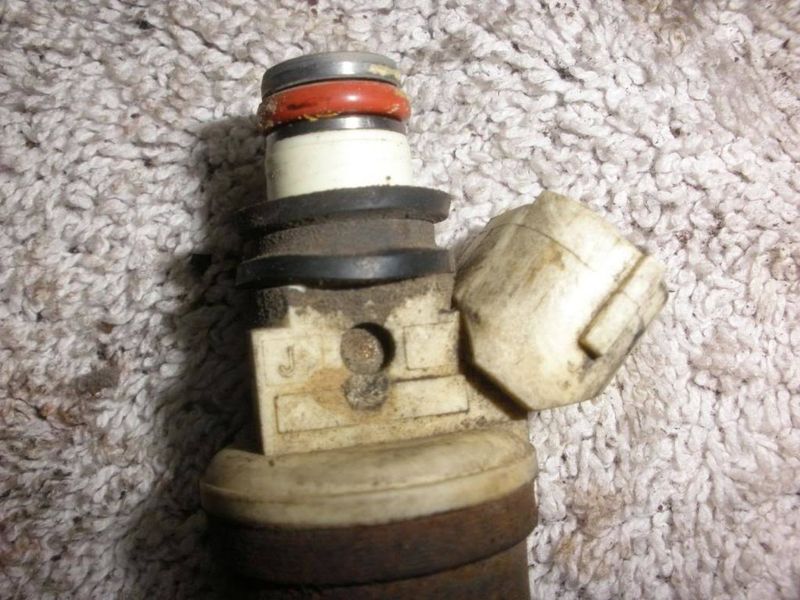

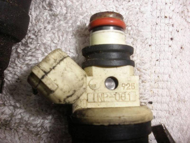

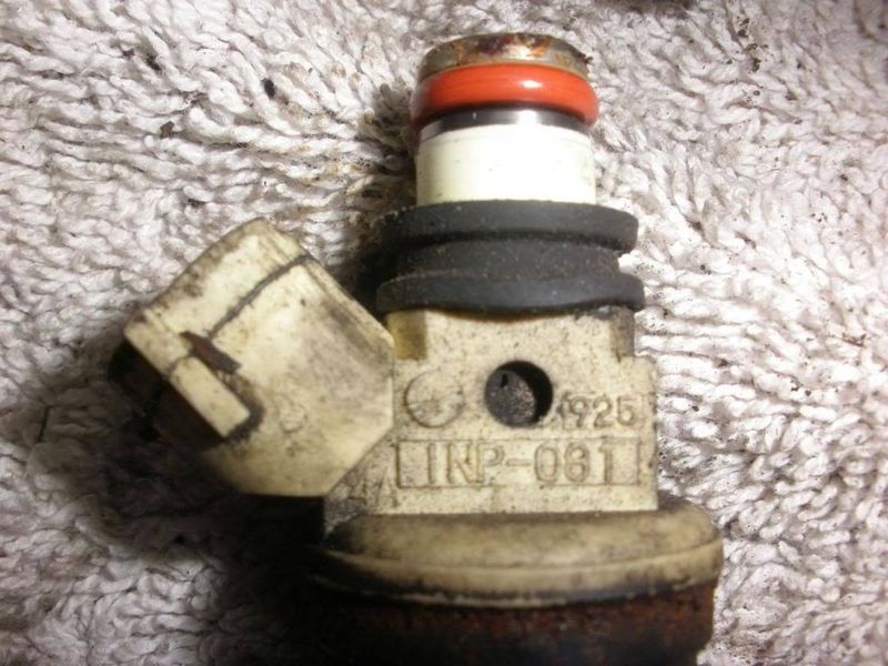

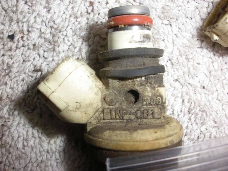

I am in the process of rebuilding my OEM EFI assembly for a EFI upgrade later this summer. I acquired the parts from a pair of 93 EFI 2.2 trucks. My injectors (all 8 ) have a different number and letter on them. I think it's the same part number but maybe a different "sub" part number? F2G813250 is the OEM part number and they cost $160 new!! So hold to OEM units if they are good ones!!! Here are a few sample shots.

I knew I'd heard the JECS name before - they are used by lots of Nissan guys, whenever I see them they are the side feed type - interesting that Mazda chose them.
