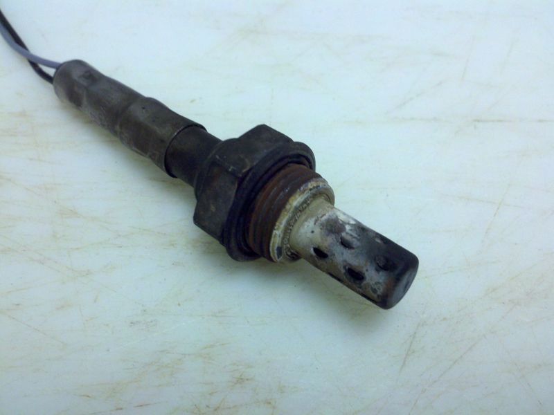

I failed the California smog check so I paid a mechanic to diagnose the engine and both the oxygen sensor and catalytic converter tested way out of spec. I replaced the oxygen sensor and noticed that the old one has some white and beige corrosion around the base of the probe. The tip of the probe is black and sooty. Is it normal to see corrosion on this sensor?

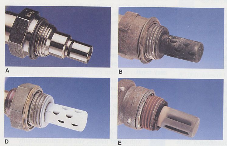

Did it look like this?
Or like "D" here?
If so, that isn't corrosion, it's carbon buildup.
A: New 02 sensor
B: Oil Fouled 02 sensor
D: Carbon Fouled O2 sensor
E: Normal wear O2 sensor
The cause of carbon fouling is a rich condition, or oil consumption. Both will kill cats too!

Here is a pic of the old oxygen sensor. I think it appears to be most like photo "d" but with areas that are like "b" and "e."
I do believe I'm burning oil but I have been a little ever since I got the truck 50k miles and six years ago. I add "engine restorer" once in a while and the problem seems to be progressing slowly or improving. Maybe I can just do that yearly and it will stop burning?

That O2 looks fouled to me, I would replace with a OEM Mazda part and not any generic one.
